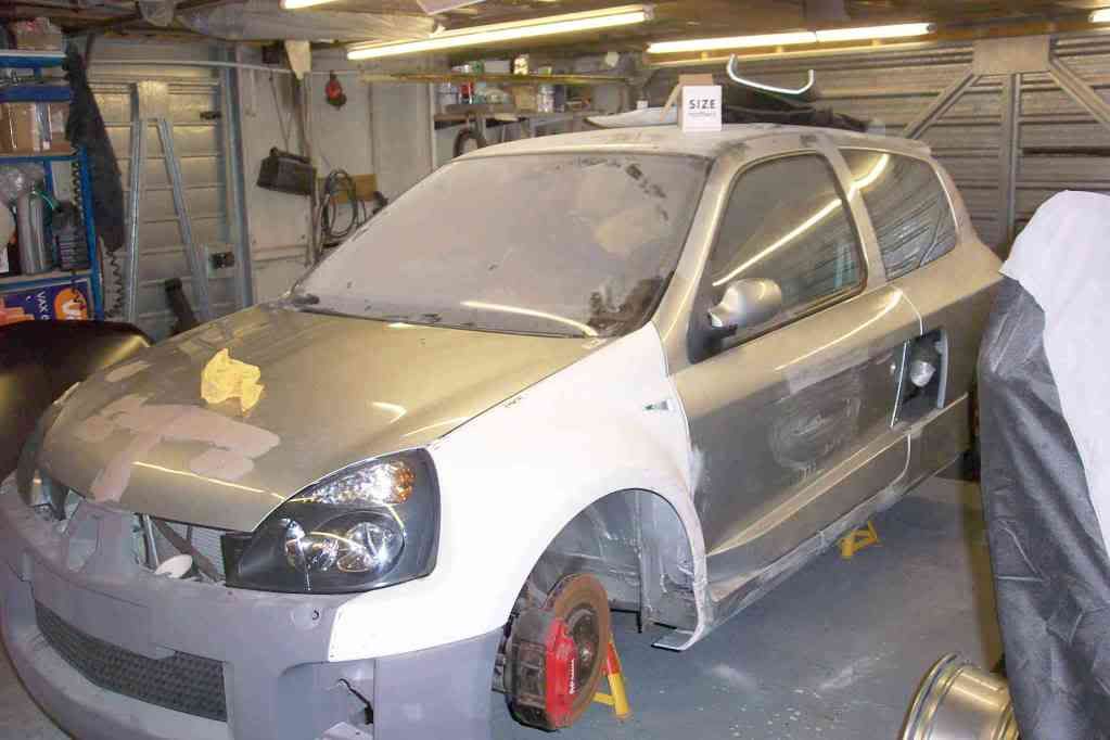

This is when I picked it up, GULP

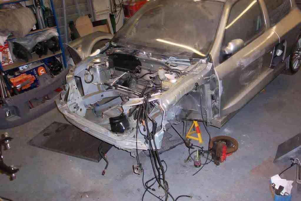

NS front end, suspension stripped off for painting and checking, hence why I found the broken spring. new bumper blade fitted with new subframe.
all checked and painted.

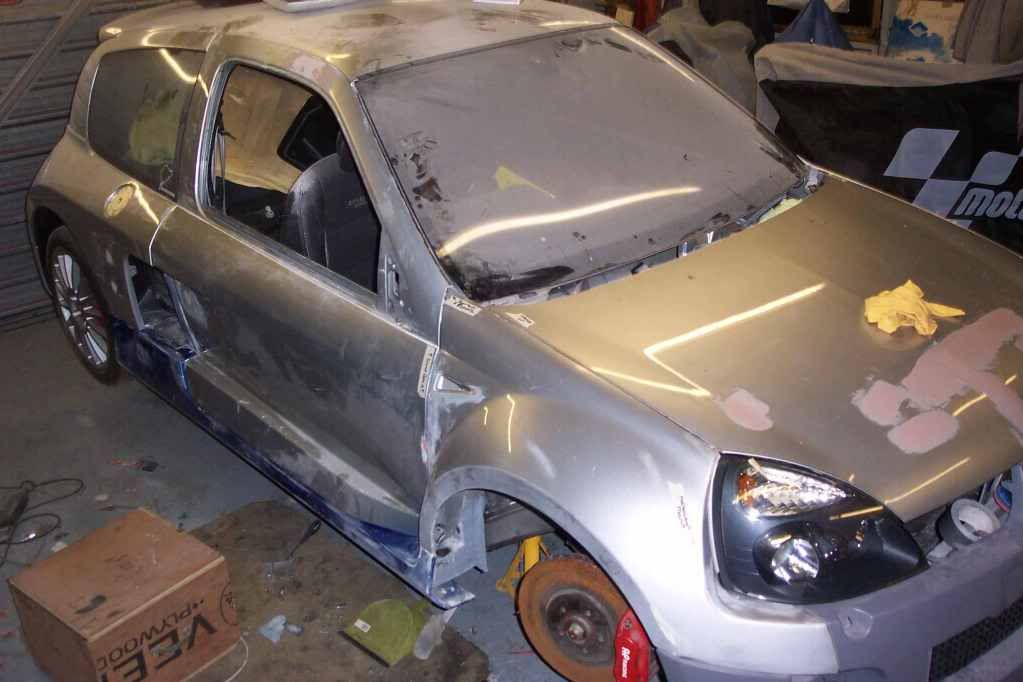

test fitting of panels checking the gaps. bonnet failed the test so replaced.

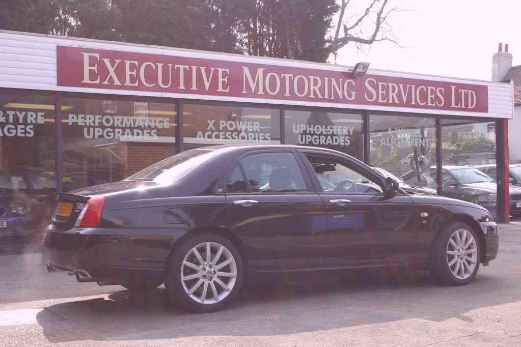

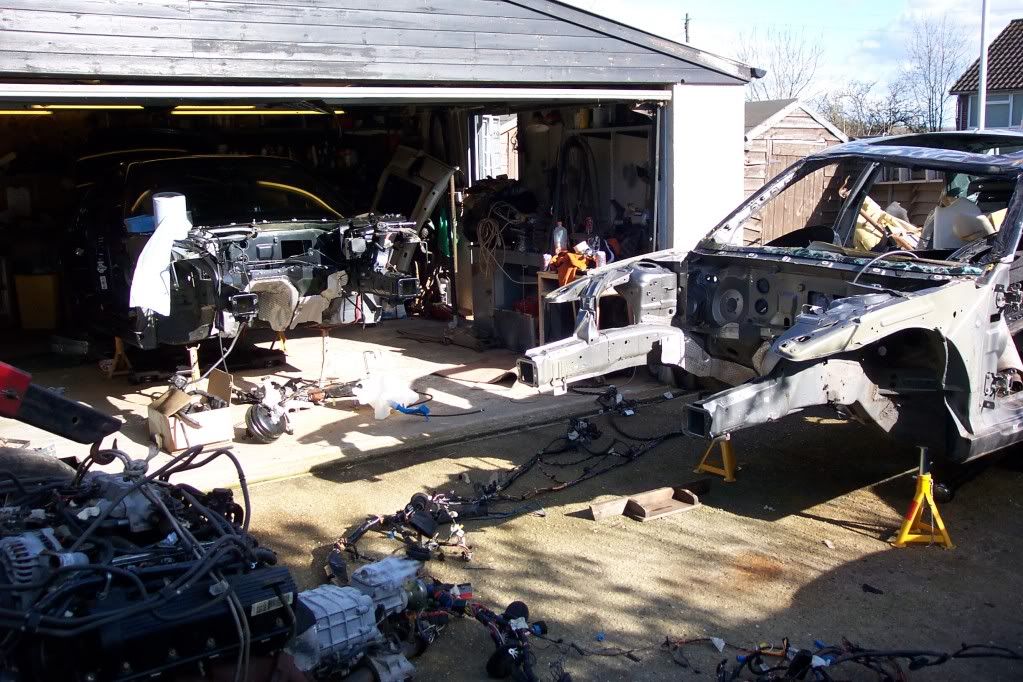

Rolled MG ZT V8 limited edition during full re-shell
1
finished car registarted as new car.
