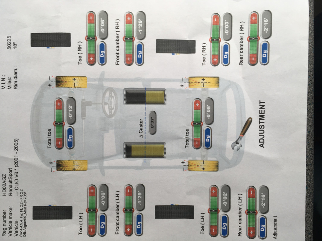

I’m surprised it has more negative camber for the rear axle.

He took it out for 15 mins and his thoughts were that the steering, although reacting quickly, wasn't quickly enough for him. He felt the alignment was likely out a little also....how he manages to come up with this I have no idea. Told him it had a full alignment when the KW were fitted and he replied that changing wheel / tyres can have a detrimental effect at times....also as suspension bushes wear slightly that can also affect things.
Have already spoken to Scott re spring rates etc and different set ups.
I suggested to the guy about raising the rear 3mm and he said there'd be no need, he'd do a complete realignment and take it from there...spent ages doing it and, as Scott did, paid huge attention to accuracy of the settings. He took it out again afterwards and was happy with it and my thoughts were that if he was happy I'd be delighted.
The car feels different again, still very firm yet no rattling or crashiness that had started to creep in. Asked him if it would benefit from corner weighting and he replied definitely but not yet, told me to take it away and drive it for a while to make sure I was happy with the feel then look at corner weighting.
