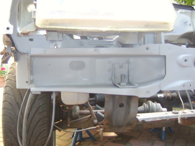

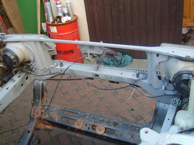

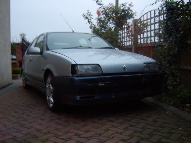

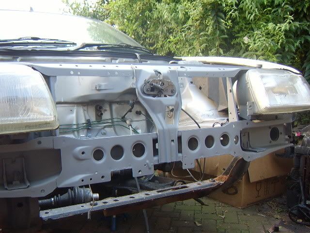

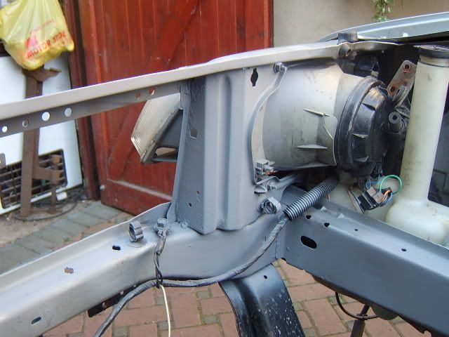

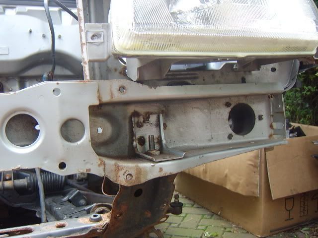

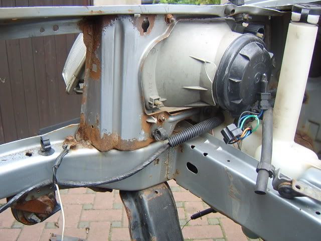

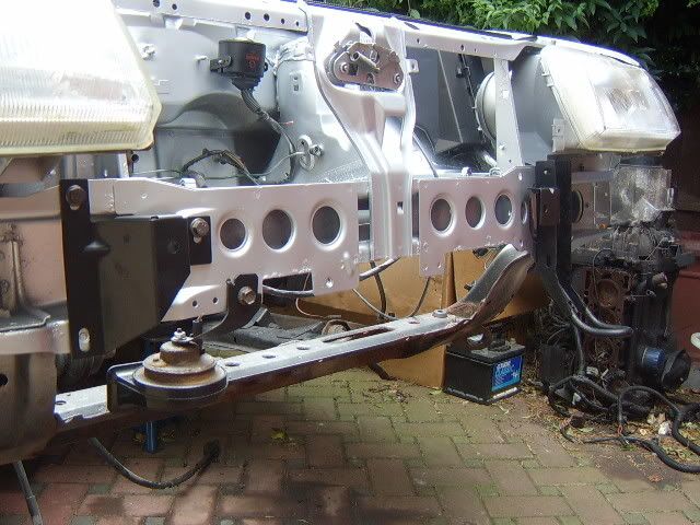

Before and after pictures of initial derusting and priming:
And some other random ones......

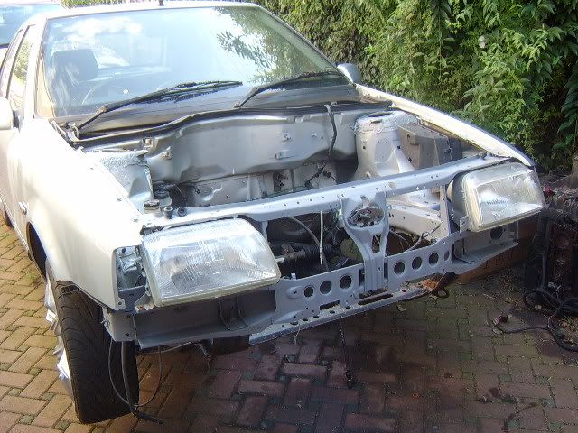

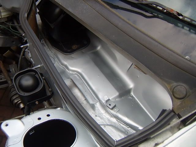

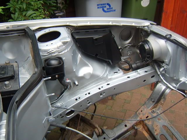

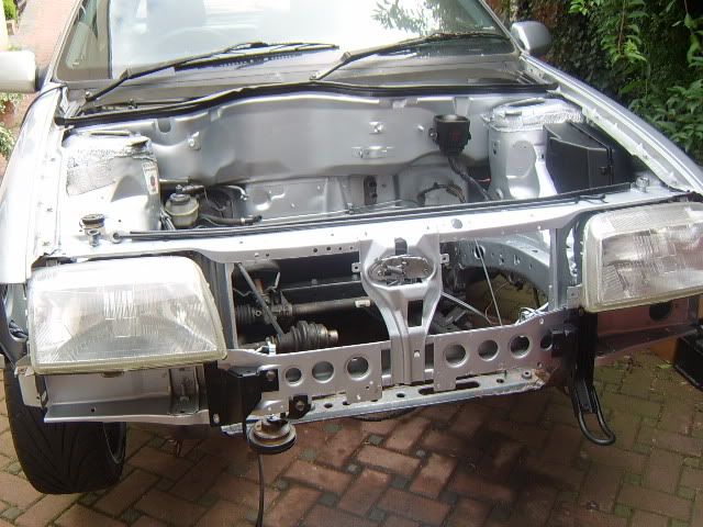

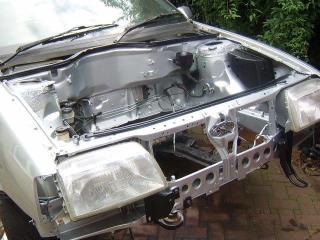

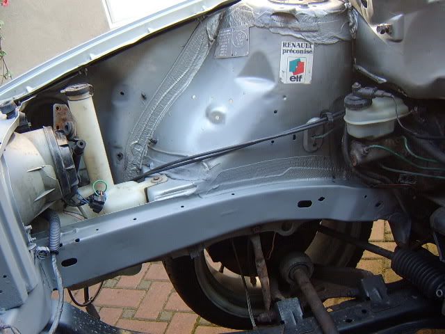

I finally started rebuilding the engine bay and did a few other tidying up jobs.

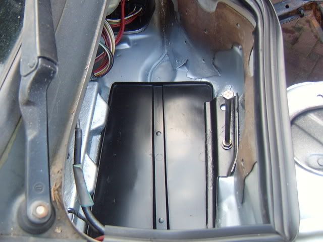

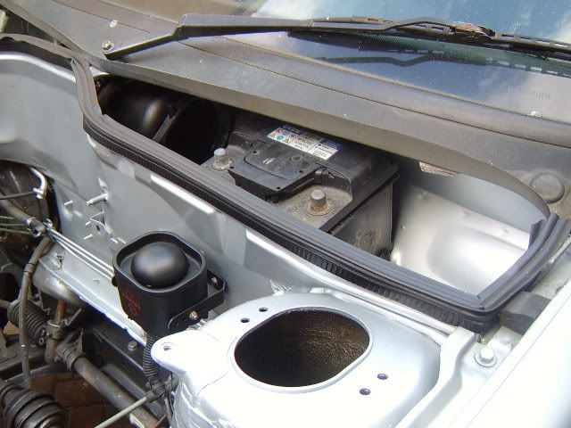

First job was to hoover up all the leaves and other bits of foliage that had fallen into the scuttle over the last 9 months, this was because I wanted to relocate the battery across the other side of the scuttle, to give me room to mount reservoirs for the pedal box that'll be going in. The purpose of the pedal box is two-fold - to facilitate use of an indepent brake biasing system, and also to provide a hydraulic output for the clutch on the L7X as the existing clutch pedal setup is (as you all know) for a cable operated clutch.
I removed the battery and undertray and bracket and found that rust had started to get a hold, so on with some Kurust again (I love this stuff) and some primer, paint and lacquer later it was looking good as new!
Also did the other side for good measure, want the battery to have a clean new home :)
Trial fitted battery:
Back on the other side, I painted the undertray and bracket satin black, and gave the long bolt a go on the wire brusher and reassembled:

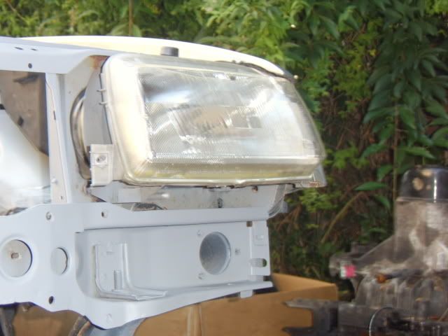

The satin black paint came out again and was in use for a fair while. I started by recoating the towing eye, front plate, alarm siren bracket, washer bottle cap, auxiliary fuseboard cover, headlight covers, bonnet strut, and I even did the long rubber trims that sit on the scuttle and slam panels.
Results are quite good and just add that extra subtle feel to the whole bay.
Auxiliary fuseboard, headlight screw-cap, and alarm bracket painted and fitted, alarm siren reattached to bracket:
Painted towing eye, front plate and horn reattached and reconnected (horn)
Bonnet strut and rubber trim refitted:
Overall pic
The pictures really don't do it justice, and I'm chuffed to bit, it looks almost factory fresh!

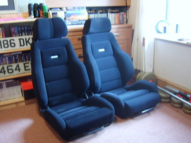

Also bought a pair of Recaro's to go in
One's been fitted with a different headrest, but no biggie really!

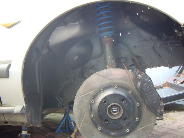

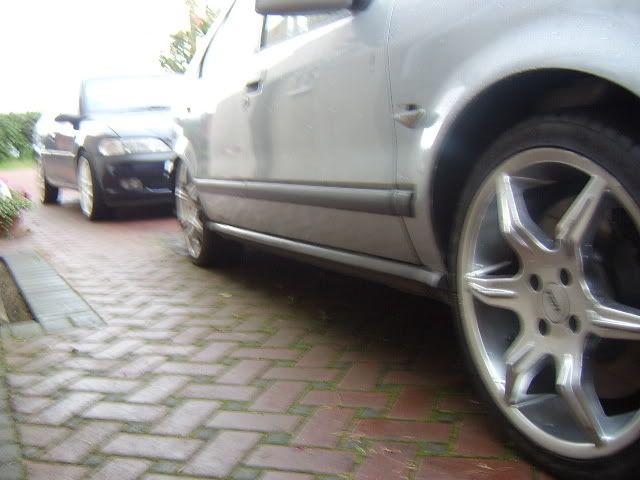

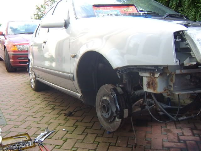

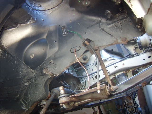

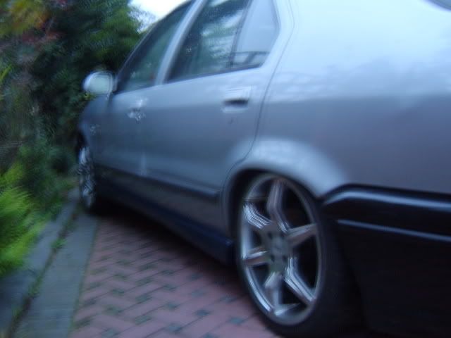

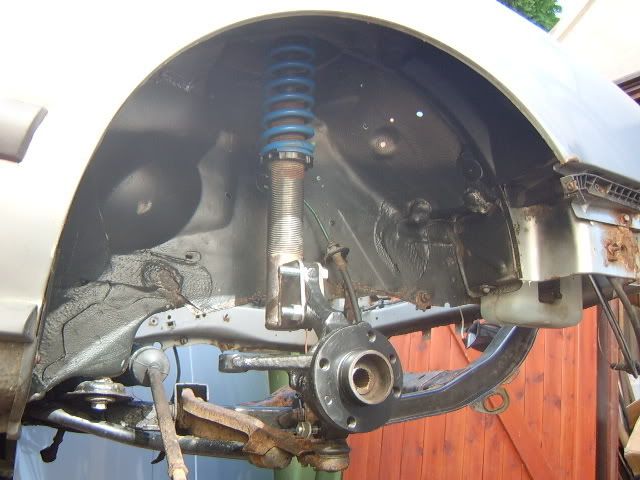

Also started rebuilding my arches, to get the car rolling in preparation for going into the garage in Lincoln to have a subframe made!
Got the drivers' side built back up at last :D

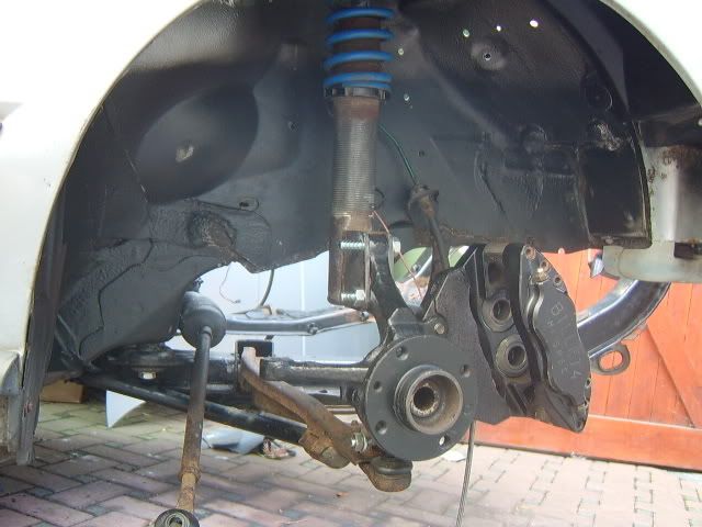

Well first job was to remove surplus Waxoyl after giving it two days to wear in the arches. A nice bit of dry rag sorted got the inner arch and turrets gleaming:

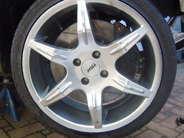

Then I fitted my lovely black hubs, and my Gaz coilover:

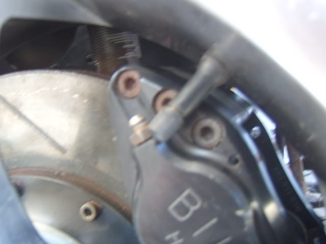

Then on with the Billet 4-pot caliper:
325mm disc:

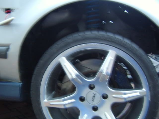

And then the wheel:
Few more random piccies:

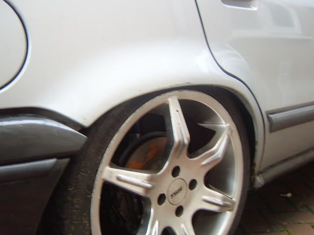

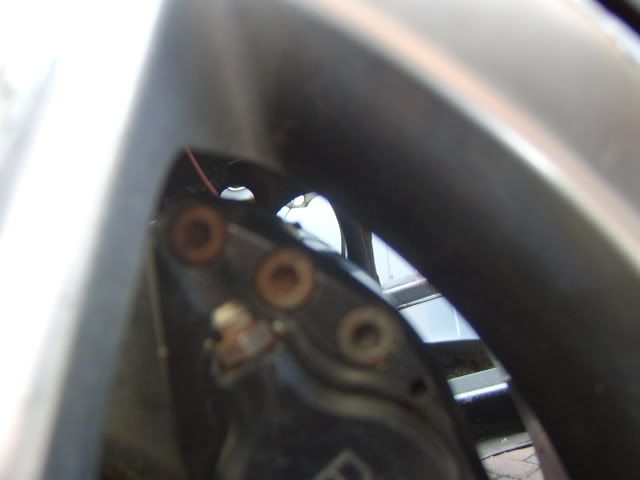

Caliper clearance - zilch!
One possible issue - tyre valve fouls the caliper! :eek:

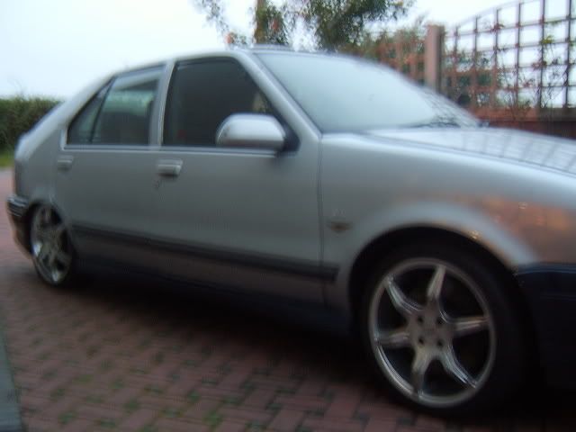

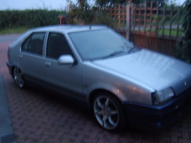

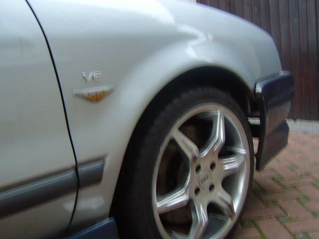

Comin along nicely! Never been a huge fan of the 19...But i do appreciate the work thats gone into it...
Need to lose the TSW rims tho...Uber gash.
I can't wait to see the finished article, must be a first??
A set of Laguna alloys might look ok on there...
Only problem is the Lag wheels are 5 stud whereas I'm running 4-studs, but I agree, they do look bob on.

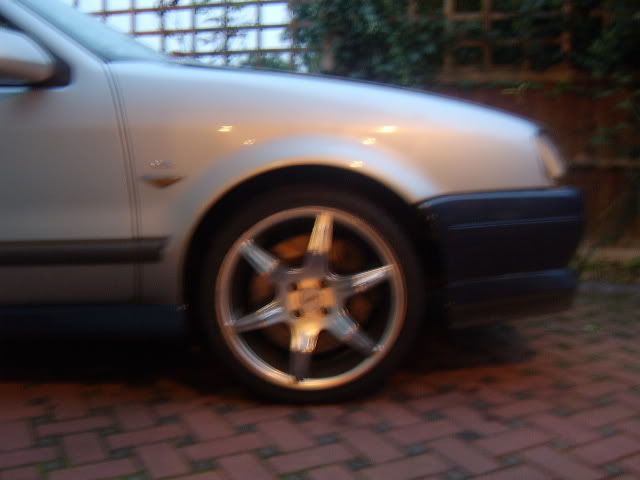

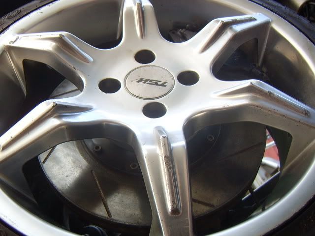

TSW's will be sticking around for a bit until I can find a replacement set of rims, I was wanting to use rims from within Renault to keep it as OE looking as possible but the only contenders at the minute are Speedline Turini's and the anthracite Ren rims as fitted to the 182 Clio, and the 17" 8-spokers from the Megane II... all of which go for big money at the minute... Turini's especially and they would have to be my favourite hehe!
I was planning on keeping the TSW's and having anthracite paint job, someone did me a Photoshop and I didn't think it looked three bad. They're not actually bad rims in the flesh, they're just not very photogenic.

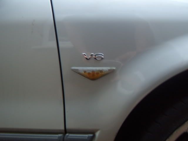

I do love the V6 Badge touch
