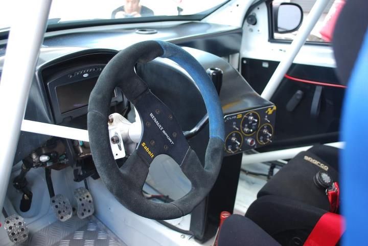

PS. attached is picture of the pedals of a Clio V6 Trophy, the distance and height between pedals are sensible for heel & toe.
That's not a V6 Trophy, that a clio 3 cup car, its easy to adjust the pedal though! you simple remove the retaining screw, pull off the arm and rotate the pedal on its splines to the desired position and refit the retaining screw - simple

To me, the pedals position of the Clio 3 cup car is good, similar to the Peugeot 206 GTI I owned before.

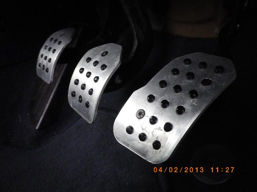

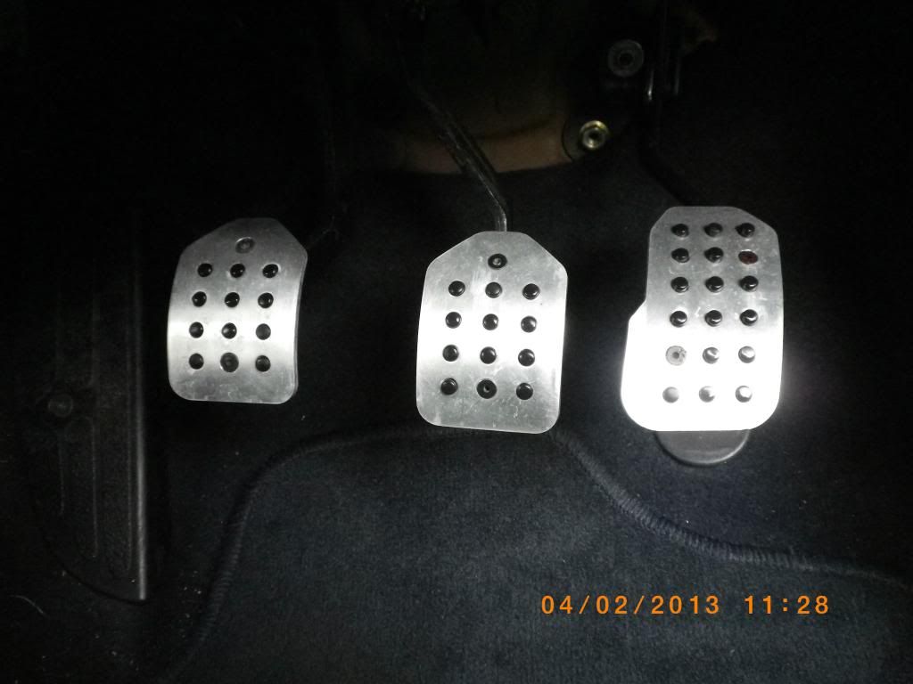

Mulgari":3maaapyw said:
I thought the same ;)
Hi Benjamin
Thank you for the picture. My friend who also owns a Vee he also uses this method to raise the gas pedal a liitle bit but he still has the problem to do heel & toe.

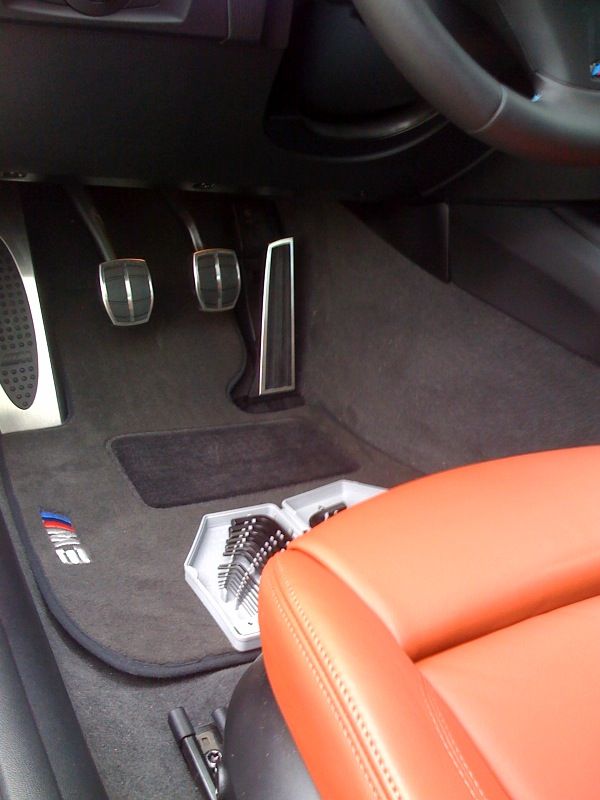

Perhaps a long gas pedal like this would help.
