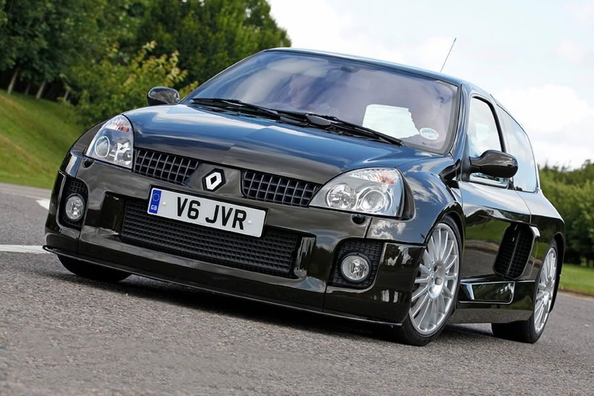

I got a bit used to the wide magnesium wheels, even though they were a bit too wide and silly, can't help thinking a wee bit wider would look better.
Can the standard wheels be pushed out a bit further?
What would I need?
Will I crash and die?
Ive asked this before mate as id like the standard 18" wheels to come out a bit more.
If there is a definitive answer can there be links to all neccessary parts required posted below...
