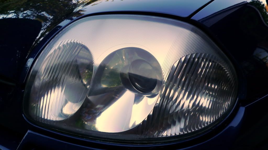

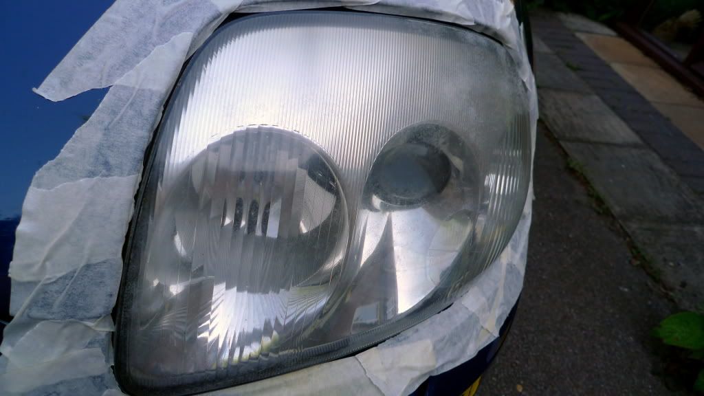

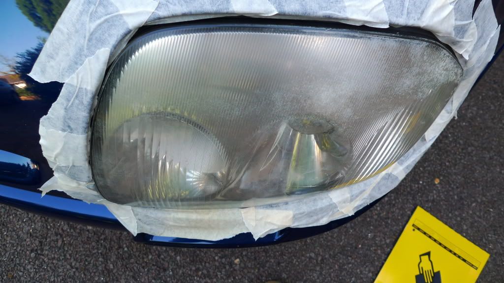

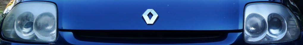

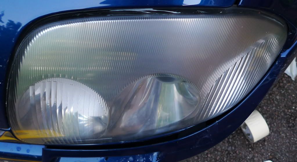

I did the following to my old 172
Wet dry sanded with grades 1200, 1500 and 2000.
Once grade 2000 was done I hand polished using Megiars Scratch X
You can see how bad they were on the very right of the first picture
Before
After
Before
After
And one done and the other as it was
