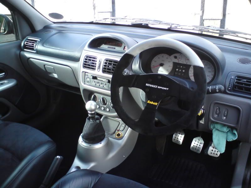

The Sabelt RS one is my favourite alternative.
Sabelt is a great upgrade, I do like the original but its fairly big. Not sure on part No. but im sure Renault Parts Direct stock them? You need a boss for them too
Thanks for those guys. So to fit a 182 wheel I'd need what exactly? Does any one have a guide or some part numbers?
Is it a straight swap or some modification required?
I do like the 197/200 wheel but not sure it'll fit with the slightly retro Phase 1 interior. Sabelt is awesome but I don't fancy headbutting one in a crash. Any idea where you can get the white/silver Sabelt wheel?
I'm pretty sure that Sabelt has been custom recovered. I believe as standard they're a blue suede/alcantara in the top section.
