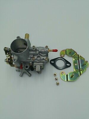

Anyway, after a bit of searching, I found a DIS carb that looks very similar, in fact I have seen them marked up for Renault Super 5 also, these are reasonably well priced at around €150, the only difference that I can see is that the levers for the choke and throttle need swapping around and maybe a few hoses need changing for slightly longer ones. Link hopefully attached to one I am considering.
My question is really is there anything very specific about the 71696 'original' carb that I have to the 5 GT Turbo, or will a conventional Renault 5 carburettor work in its place? The chap only wants it for his wedding and I don't really.fancy telling him that either his carb is scrap and he has a set of joints he can't use or that he needs to put €500 into a recon one!

The turbo carb has enricher circuits that open when the carb sees boost. That link you posted is for a normally aspirated carb and is a sure fire way of your man blowing his car up on his wedding day.
You need to purchase a carb rebuild kit £42, and sand blast the parts. Taking care to leave the mixture screw In when you blast the throttle base, so you dont funk the threads. Then spray all the galleries through with petrol in a squirt bottle.
The ebay carb will not work as no enrichment, you need the correct 32dis.
You wont find a new carb for sale easily, and then your looking at £500+ all day long.
Id get that one rebuilt, and set it up with an afr gauge. Water jacket might clean up, if not bypass the water as it makes little difference in summer.
