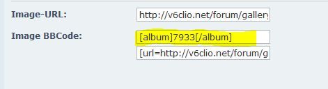

Chris I've put many of them into our gallery for you. LINK
Just copy and paste the Image BBCode: into your post for each pic.
