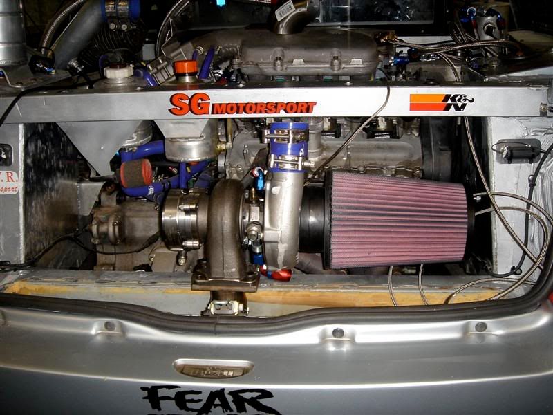

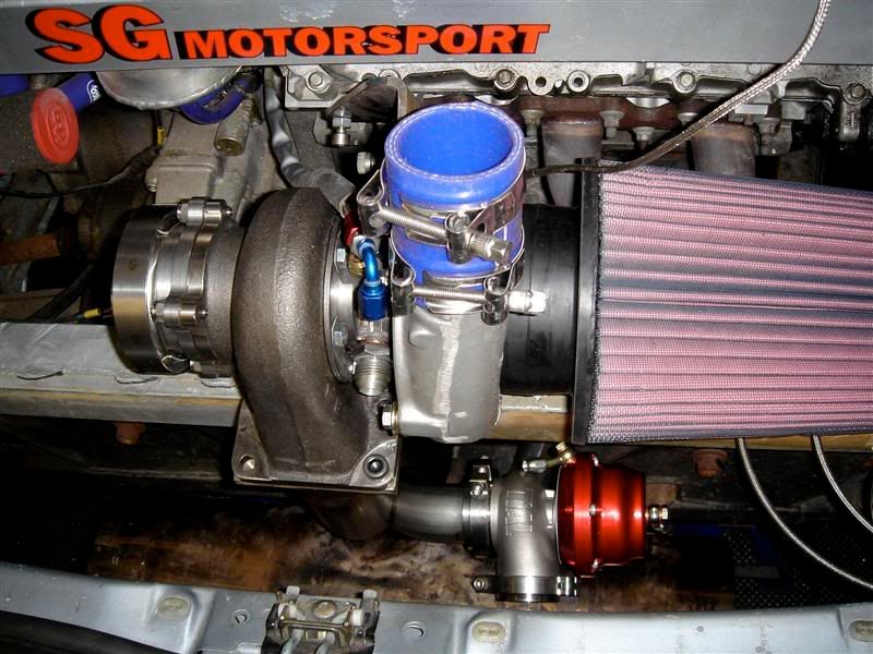

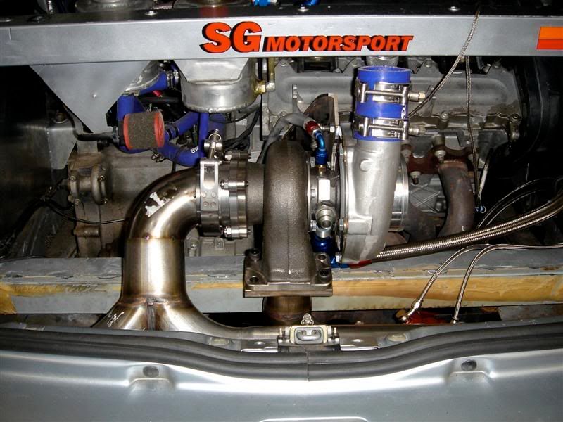

Coming along....filter will be enclosed and fed from a naca in the sidewindow.
The mad V6 just got madder - gotta love it [smilie=bowdown.gif] [smilie=bowdown.gif]
awesome, total work of art yet again.
lets get the spec up asap! will it be at french car show?
gt3076 hybrid turbo, Tial 44mm wastegate, motec boost controller, new laminova oil cooler (oil-water-air), loads of new pipes, very large K&N.
Should be good for 500+ on overboost, 450 under "normal" driving. Torque should be about 400 - 450lb/ft as well.
Mapped soon and yes to French car show.
