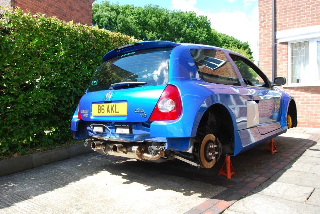

My trolley jack doesn't fit under the car. Do you just jack with the little un then get the trolley under?
Also where is the best place for axle stands? I want to take all 4 wheels off for re-furb. 8)
LINK
Good shout that actually Duncan.
In the two photos above I notice that the stands are supporting at very different points of the car. Are the jacking points different for a ph1 vs a ph2 or is it being done wrong in one of the photos?
I didn't want to jack or support the car anywhere on the sills after owning plenty Clio's I have seen the mess of them when you do. Since it was 4 yrs ago I can't remember exactly where but common sense prevails when you see the subframes Iwould imagine?

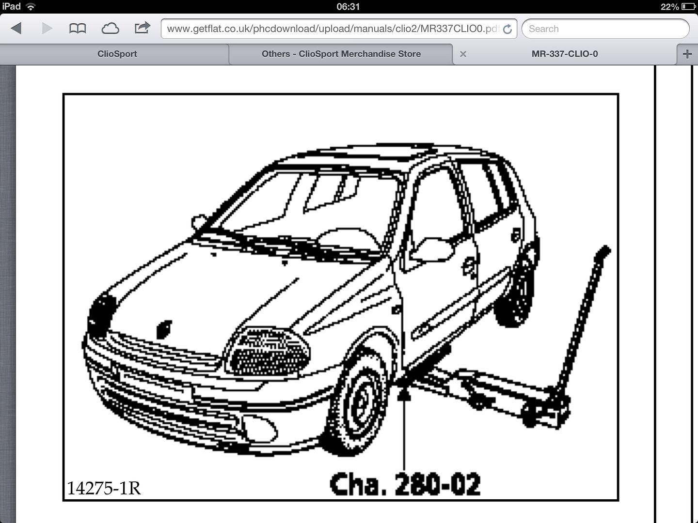

Does renault make these or anyone James?
I'm guessing there is a workshop tools part number/ code for them. Ask a local service dept maybe. Perhaps someone like Fred would know more about thing things.
Example only.....

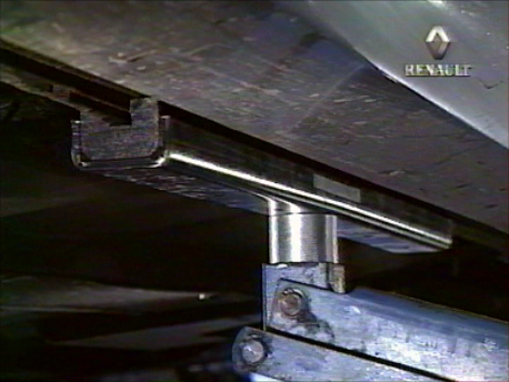

Cha. 208-02 cross piece cup
Cha. 408-01 or 02 depending on type of trolley jacket
Wonder if Russo can fabricate one.... ;)
Not a lot to it Matt, I did look at it and think Hmmmm, nice idea to distribute the load ;)
Only a piece of 'U' section and what looks to be some hard rubber with a groove down it. But as everyone uses different types of jacks with different fixings it couldn't be a one for all. Might have a look in to it :approve:
