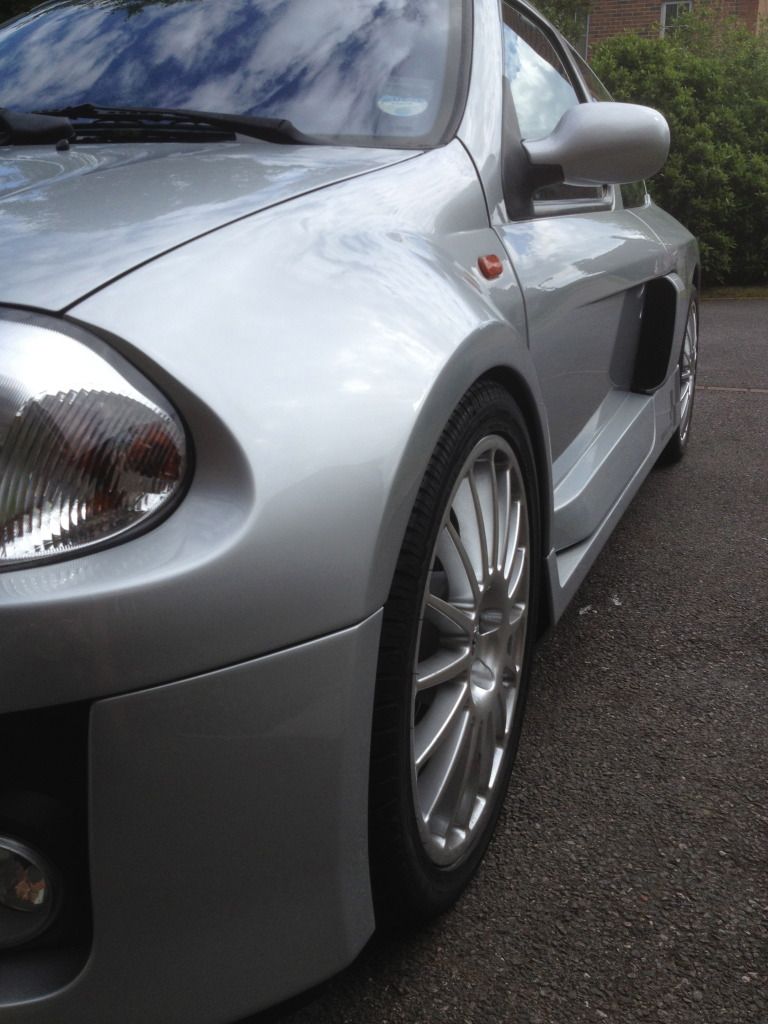

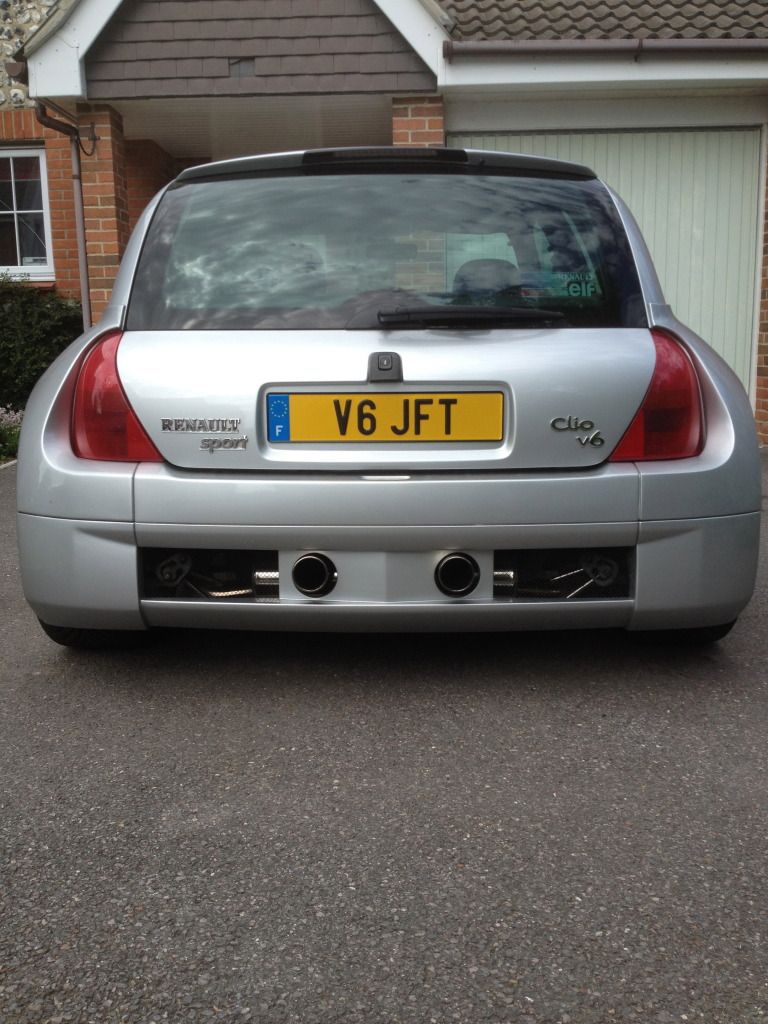

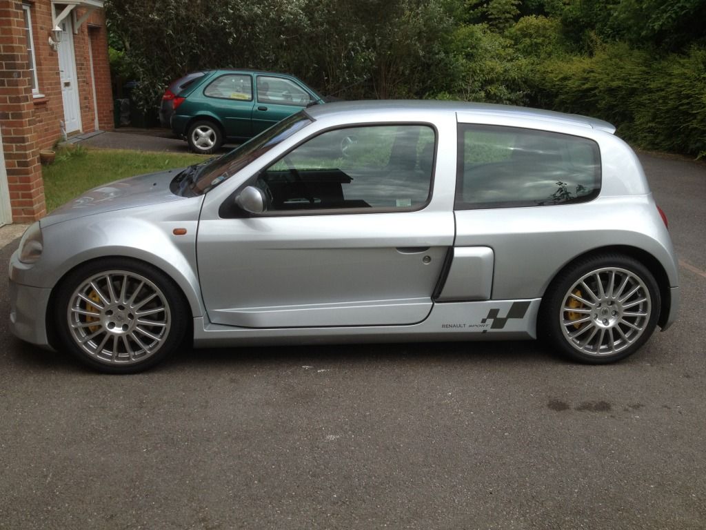

Just a few pics so you can see how the spacers look on the car :)
Cheers mate, super sexy example you got there! 8)
