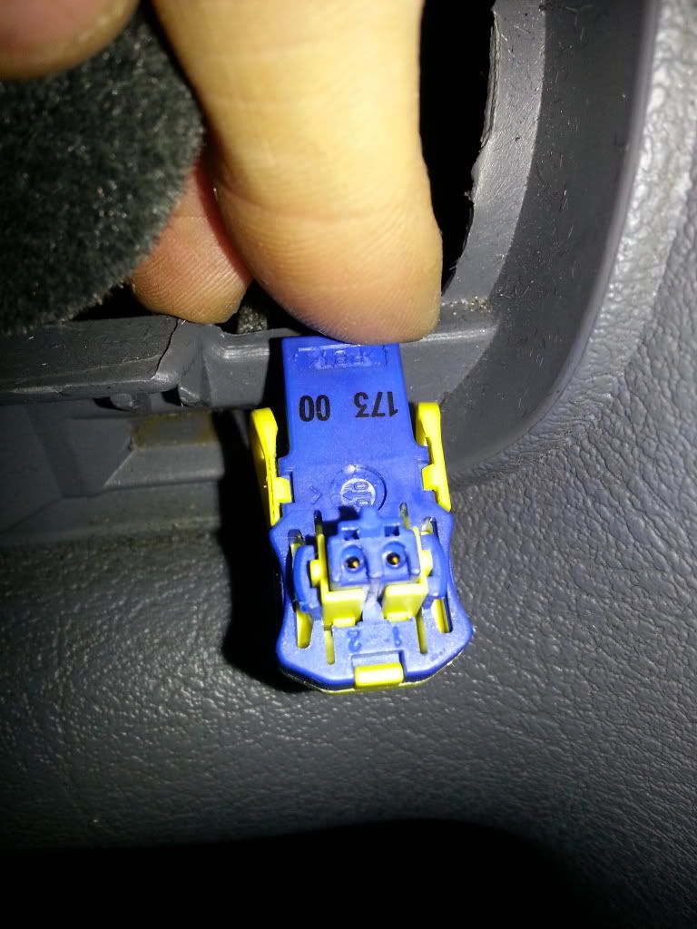

Hi guys, my airbag warning light has been on since I purchased my car. I've removed the dash this evening and found that the connection wasn't plugged in properly/at all. The only thing is I can't release the clip to so it can be reattached

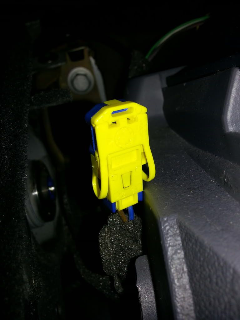

Photos will help. The yellow half of the clip goes through the blue bit and the yellow bit forces the "teeth" on the blue bit to engage so it doesn't break free. I can't get the yellow bit to release so I can fit the thing to the airbag. How do I release the yellow bit?
Thanks for any help!
Sorted. I only posted as I'd spent 15 fanning around trying to get it open. Apparentlya sscrewdriver under the side near the top of the yellow bit releases it :-D
