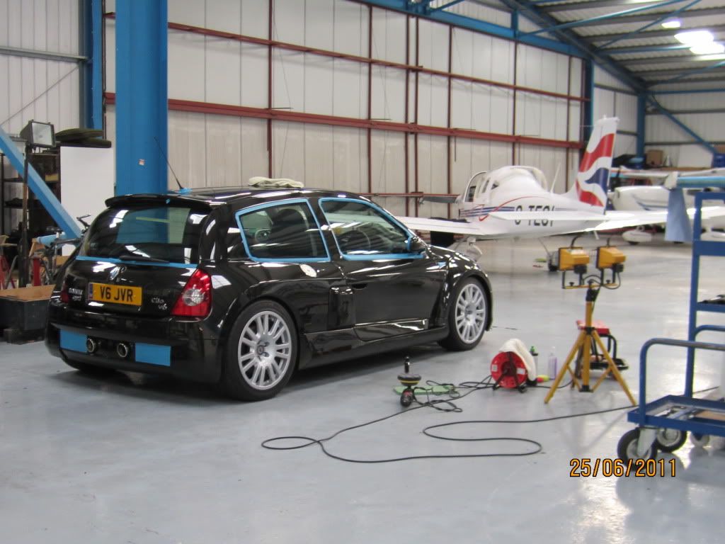

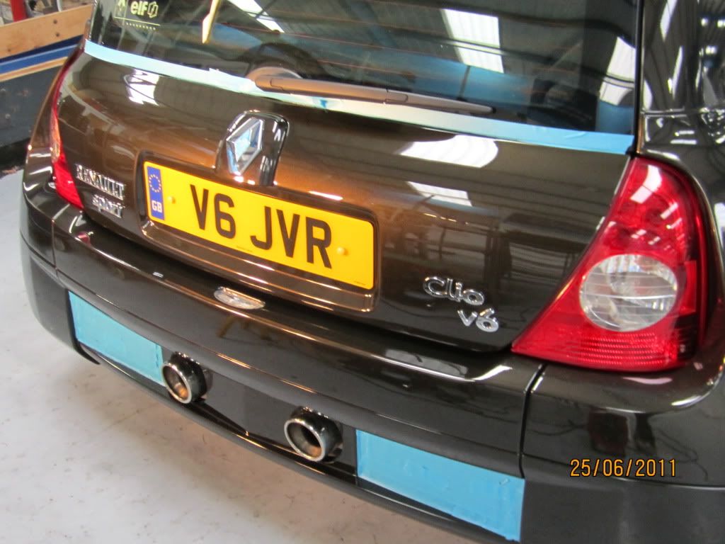

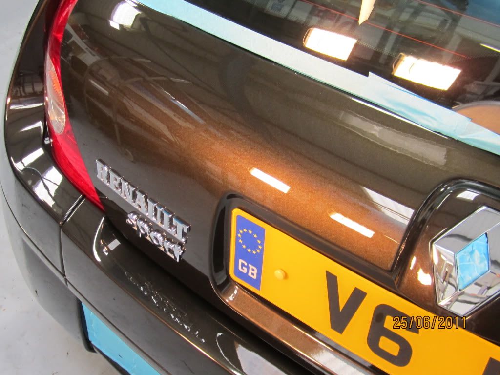

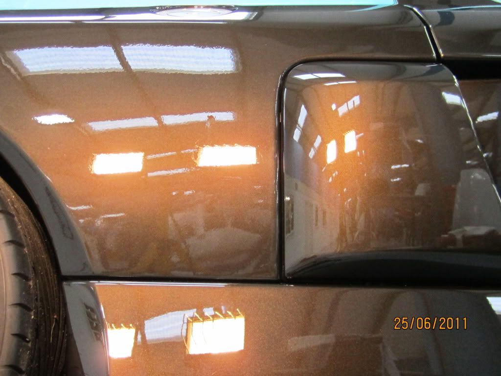

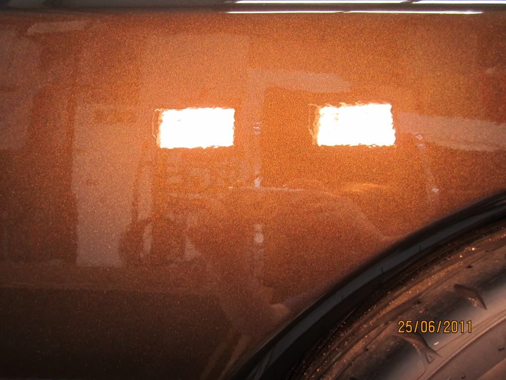

Process was -

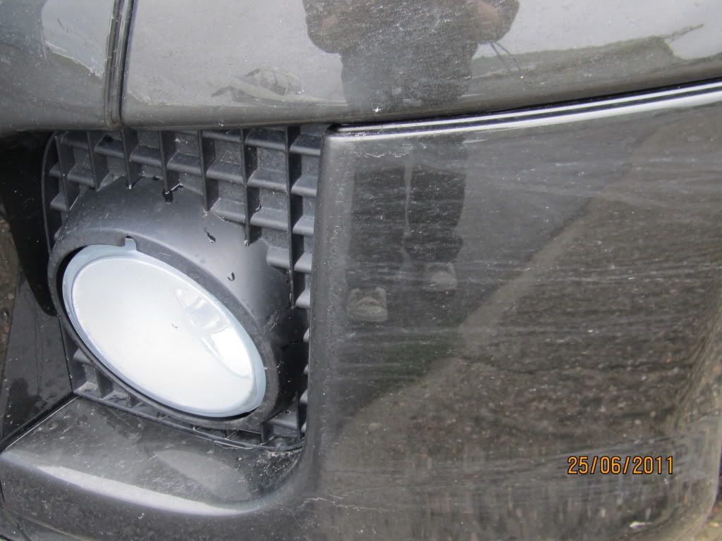

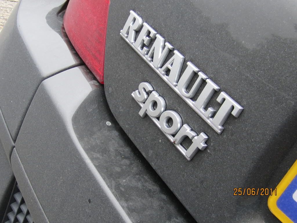

Befores

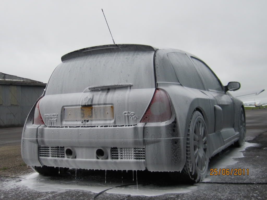

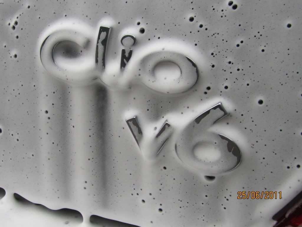

Snow foam mix of G101 & btbm

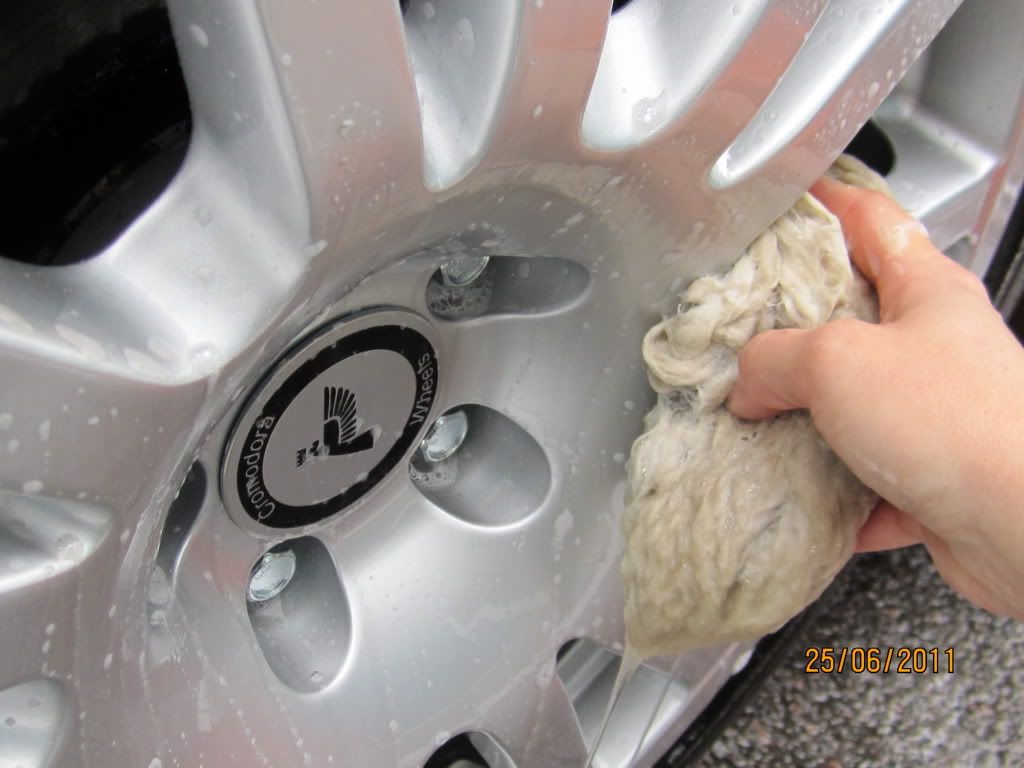

Wheels cleaned with btbm, wheel woolies, Vikan brush & dj mitt
Washed with Carpro wash mitt & btbm
Clayed with Autoglym bar & born slippy (no pics as not much contamination, very clean)
Snow foamed again
Washed
Dried with dj soft touch towels

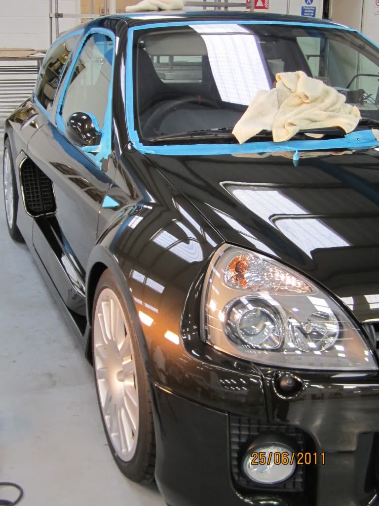

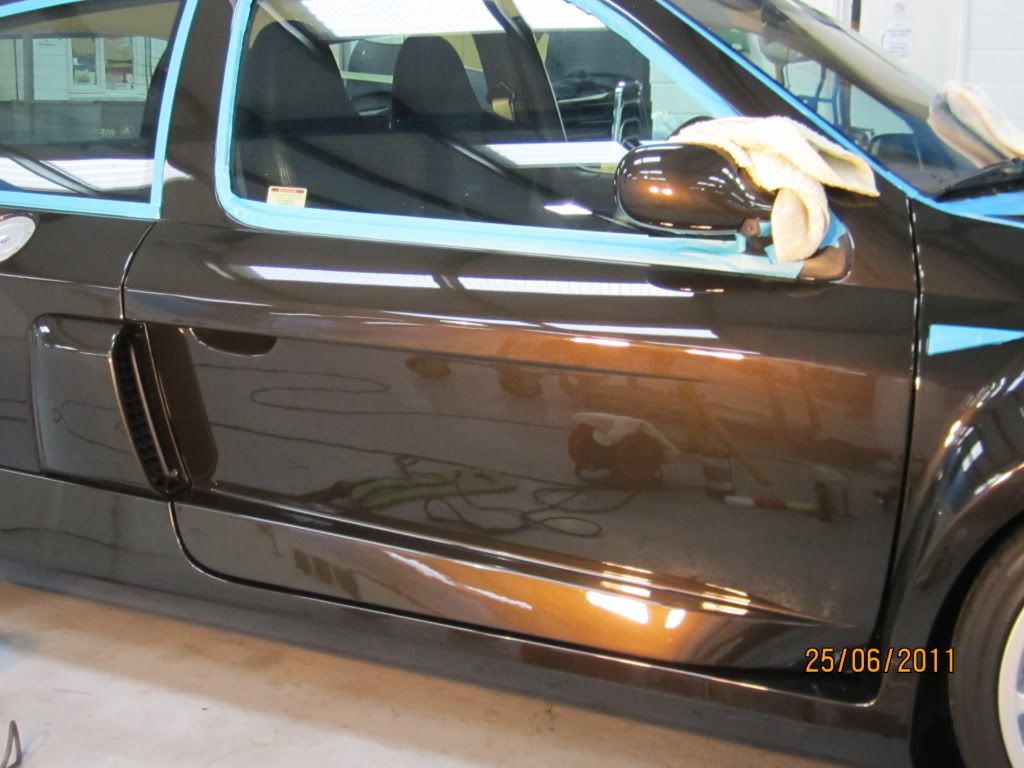

Taped up

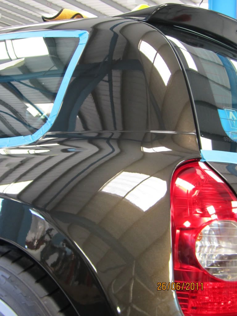

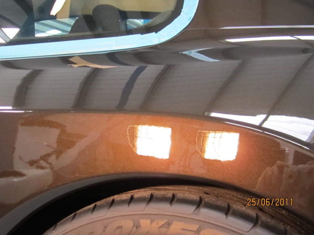

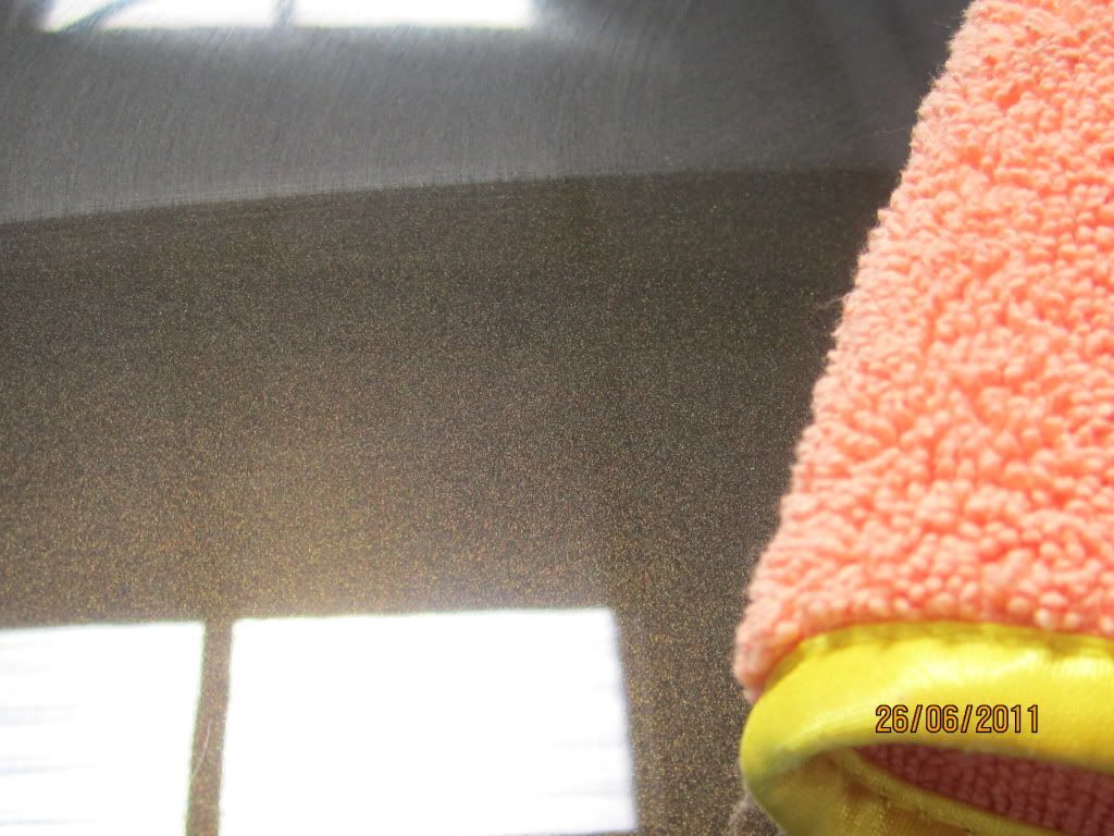

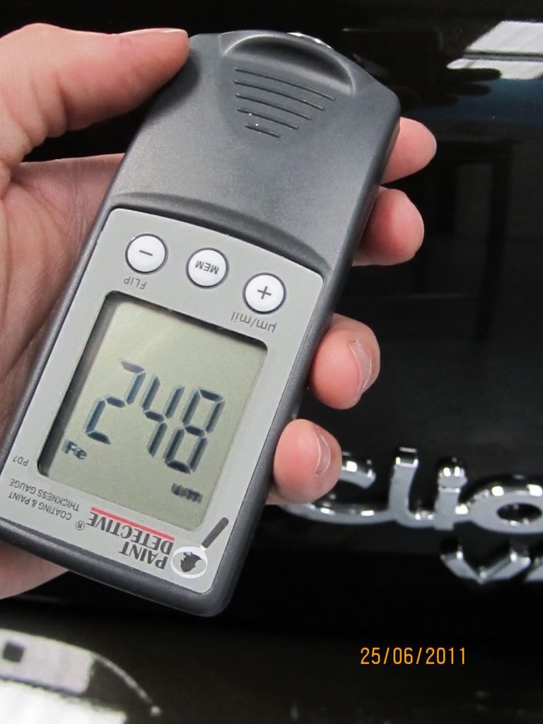

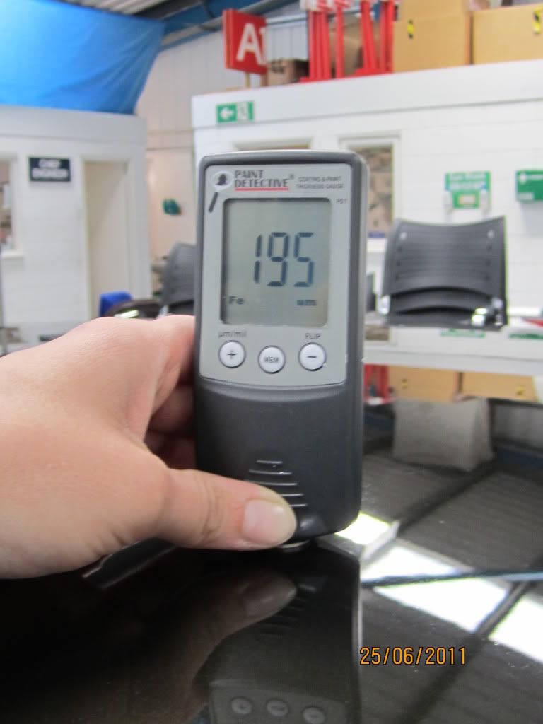

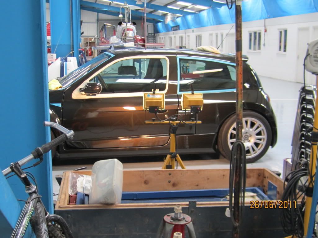

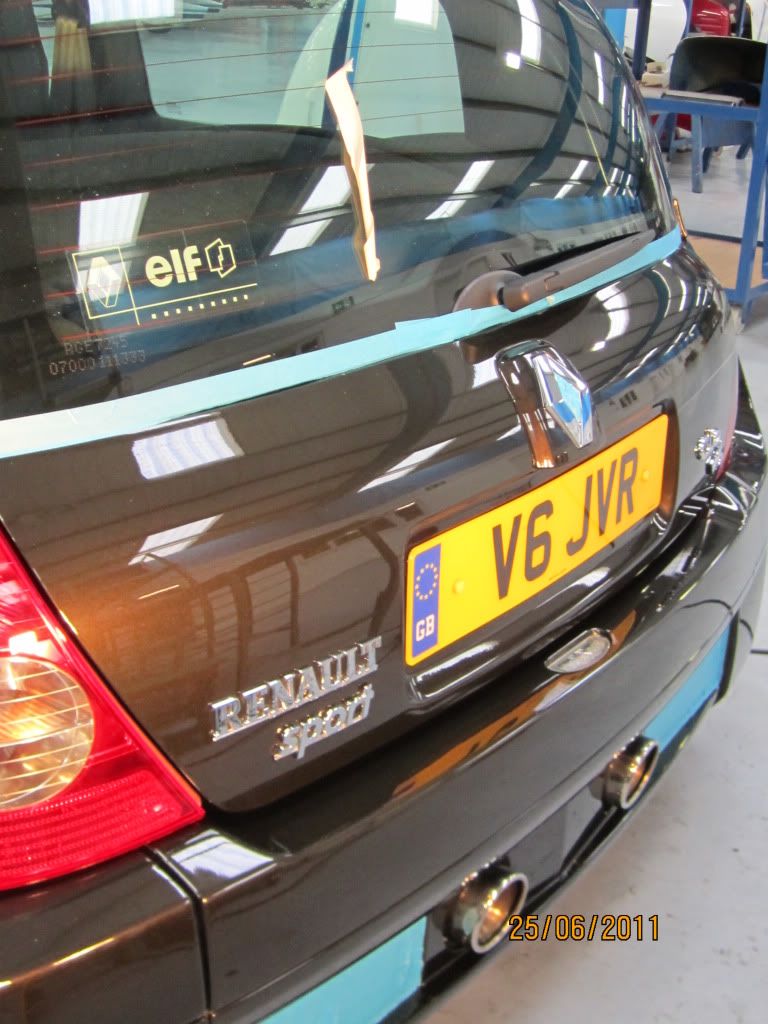

Paint readings taken (front end & bootlid respray)

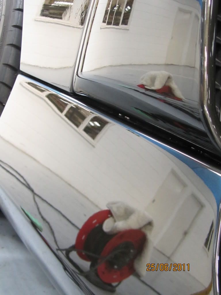

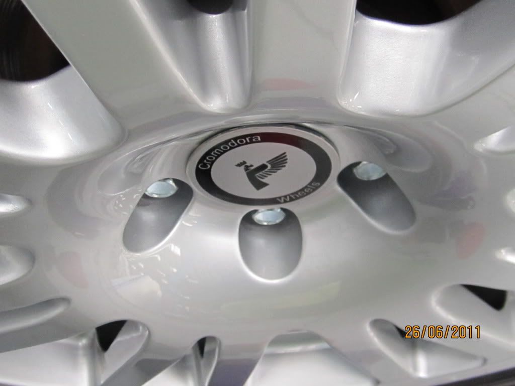

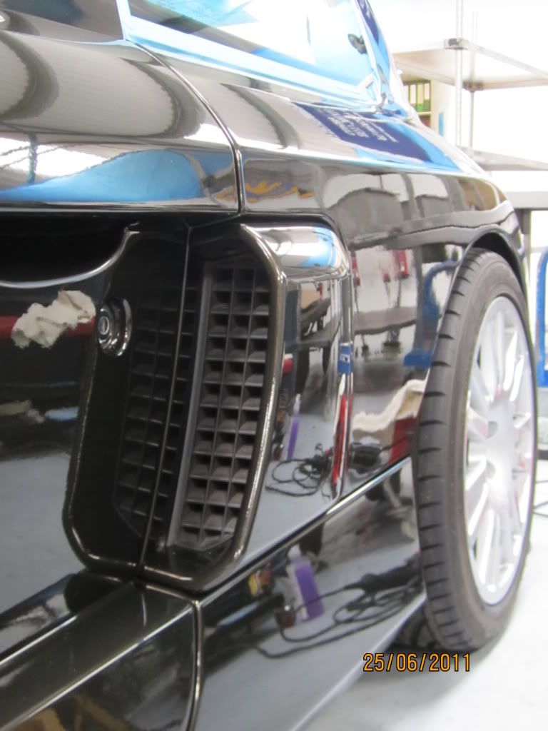

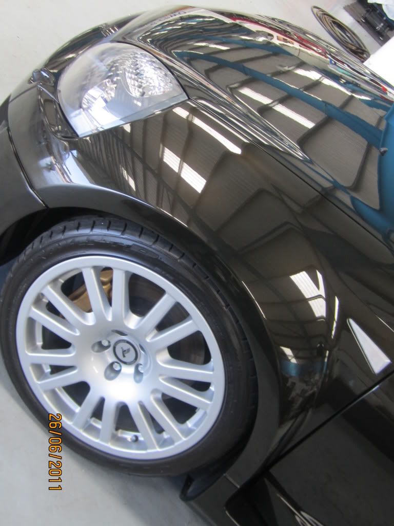

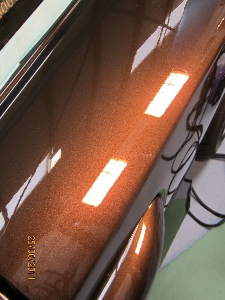

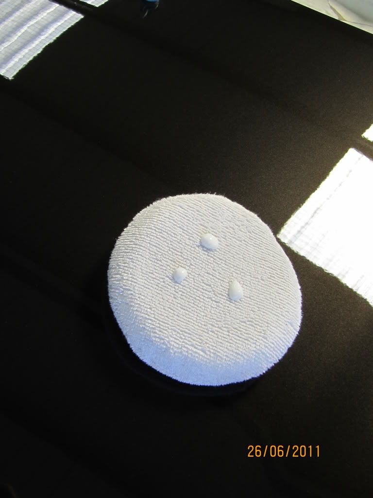

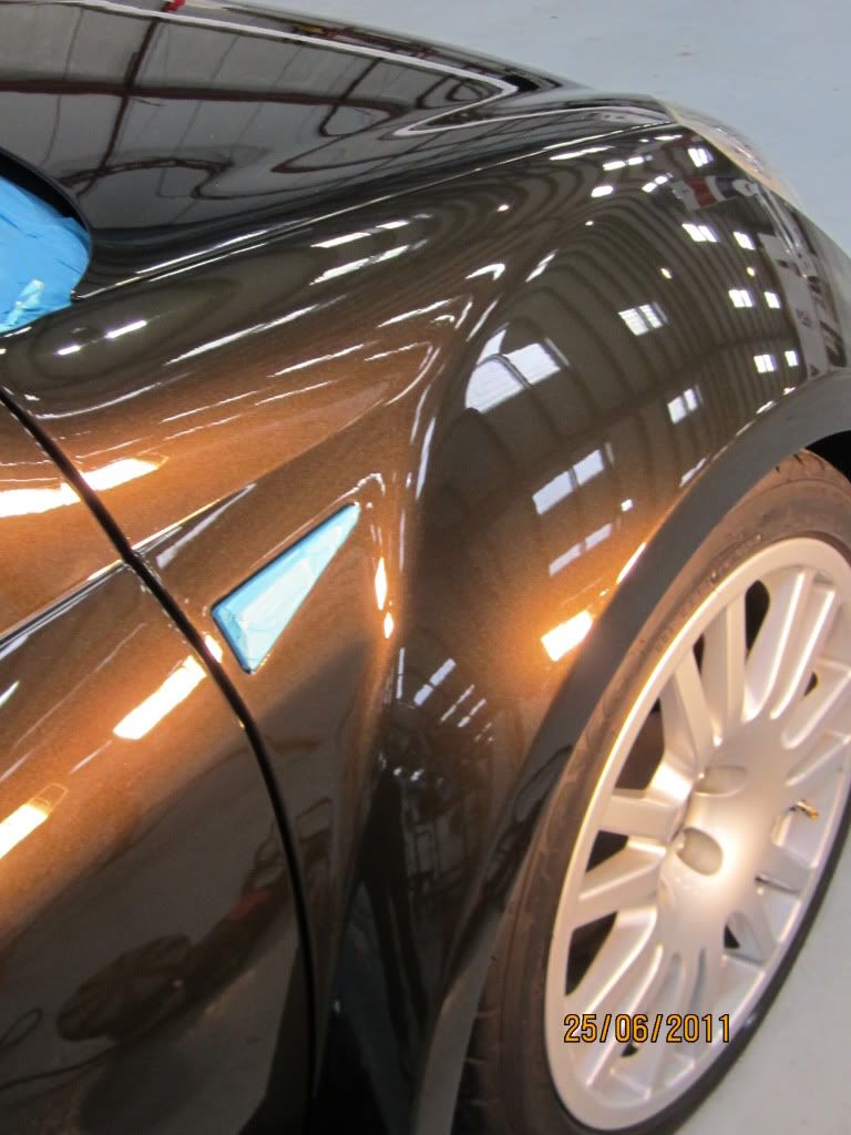

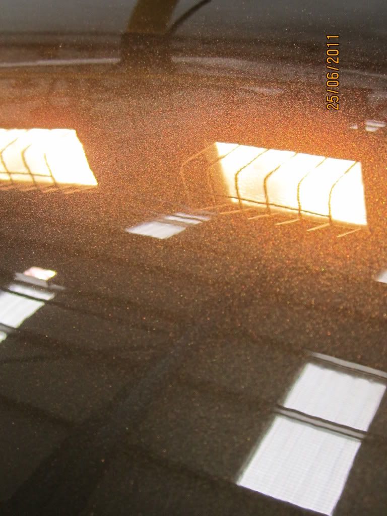

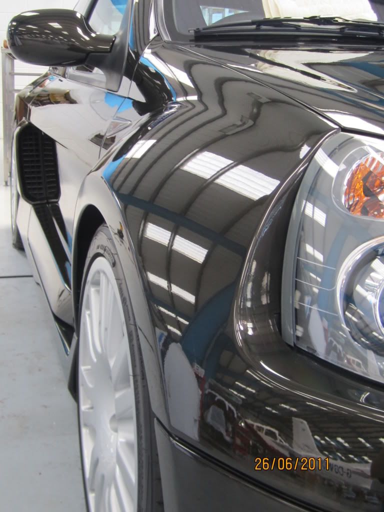

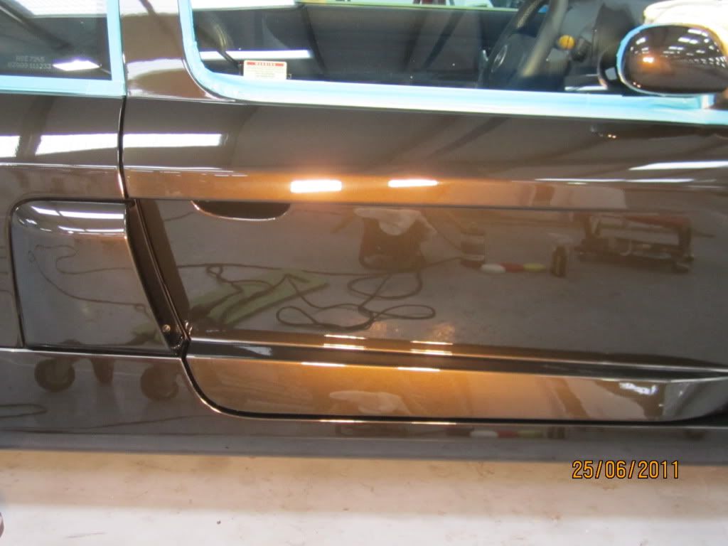

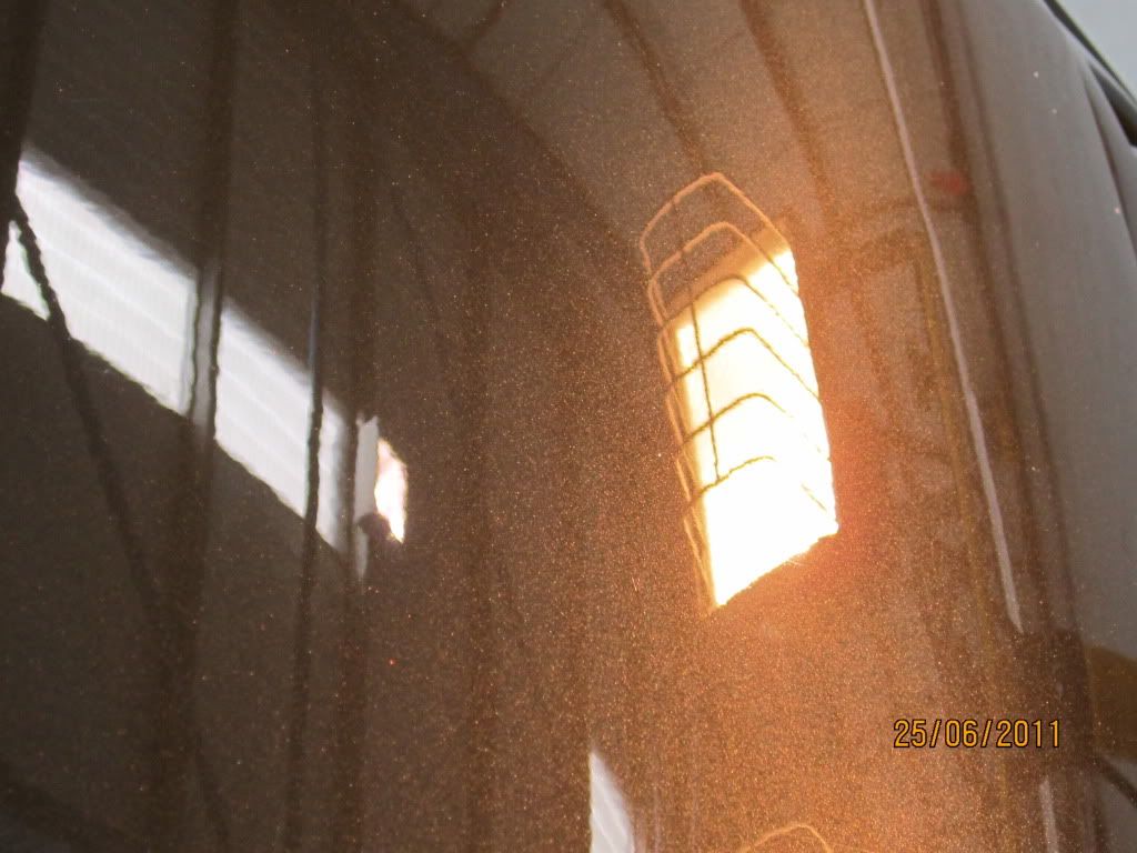

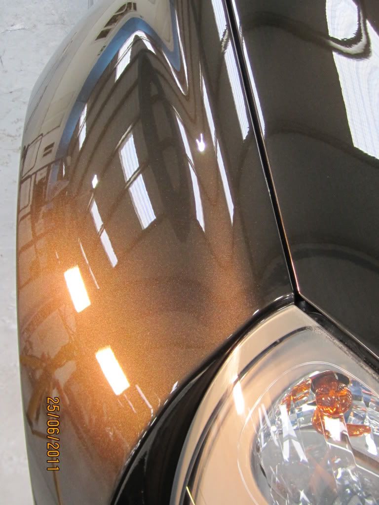

I managed to enhance the paint with 205 with a combo of polishing pads, then went over again with a finishing pad (chicargo rotary) No particular order
Wheel faces polished with a polishing spot pad & 205
Nooks & crannies lightly brushed
Door shuts 205'd

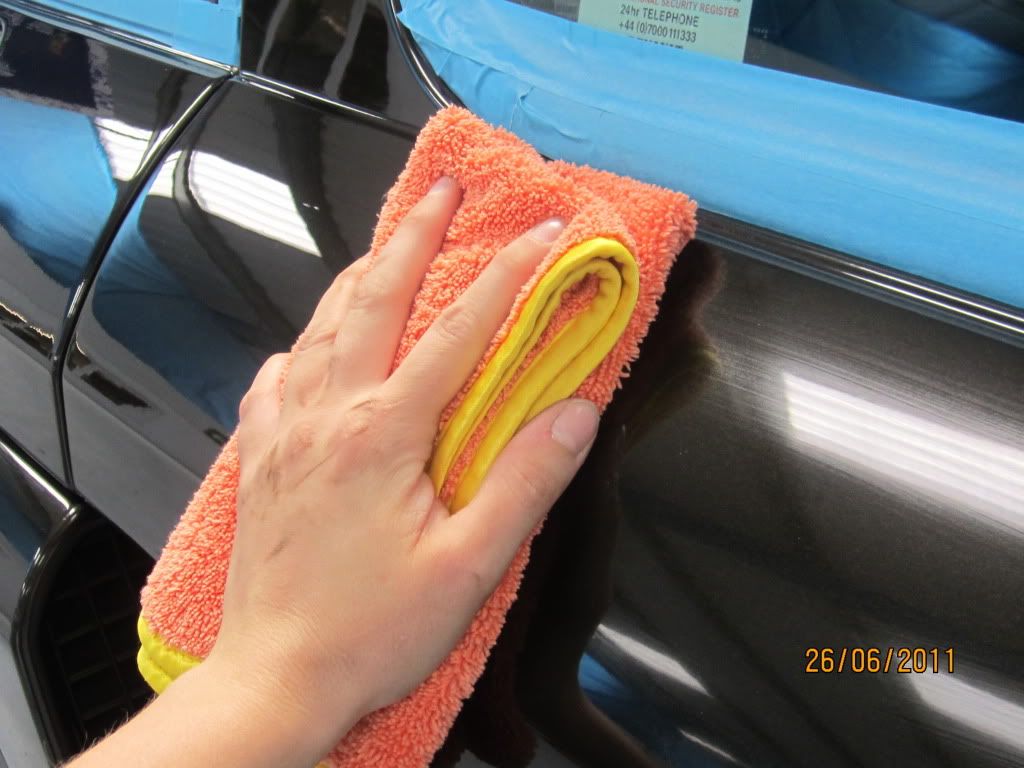

Bodywork wiped down with Gloss it QD
Then applied Blackfire enhancing polish via megs app & left for 15-20 mins
Then I cleaned the windows with dj Menthol
I then applied Blackfire Sealant via lake country app, left for 15 mins
Then I polished me windows with dj Polish
All the tape removed & dusted down

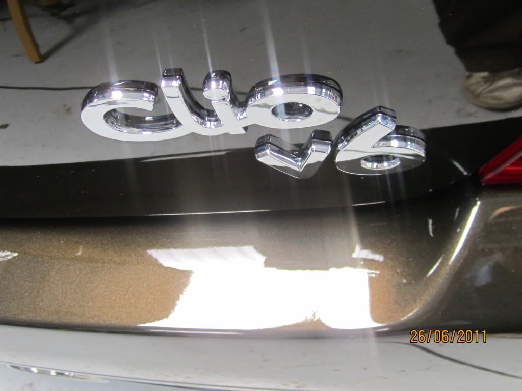

Bodywork wiped down with Blackfire Deep Gloss Spray

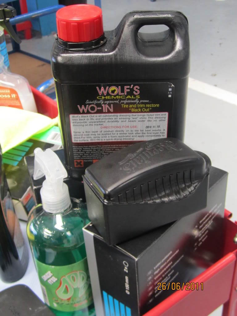

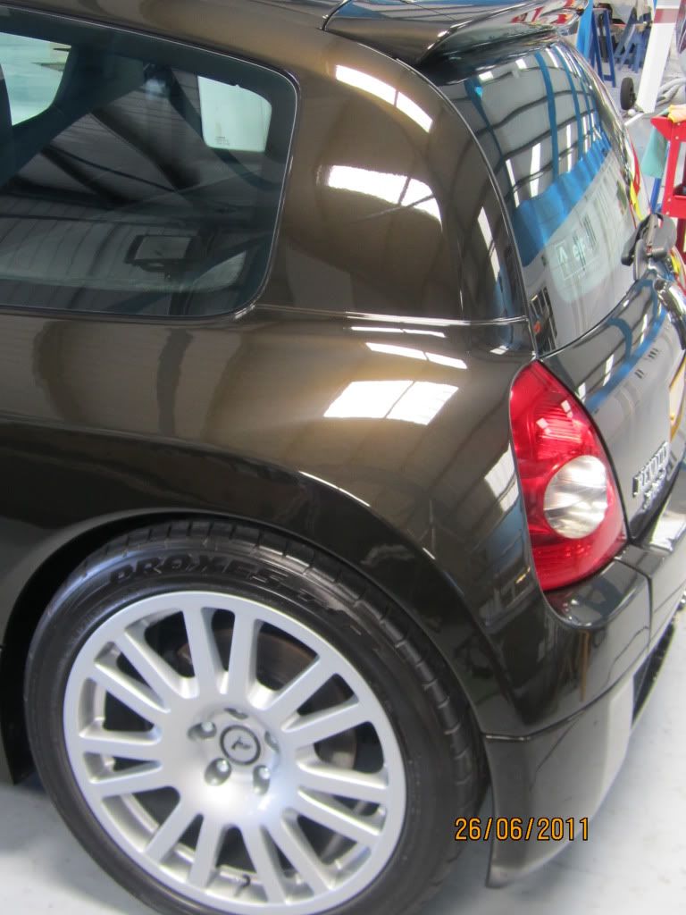

Tyres dressed with Wolfs
Zorsts polished with Autosol
I think that was it! I did want to use Project Awesome topeed with SN Hybrid but I have lost my DA spanner, so I couldn't change backing plates :wall:

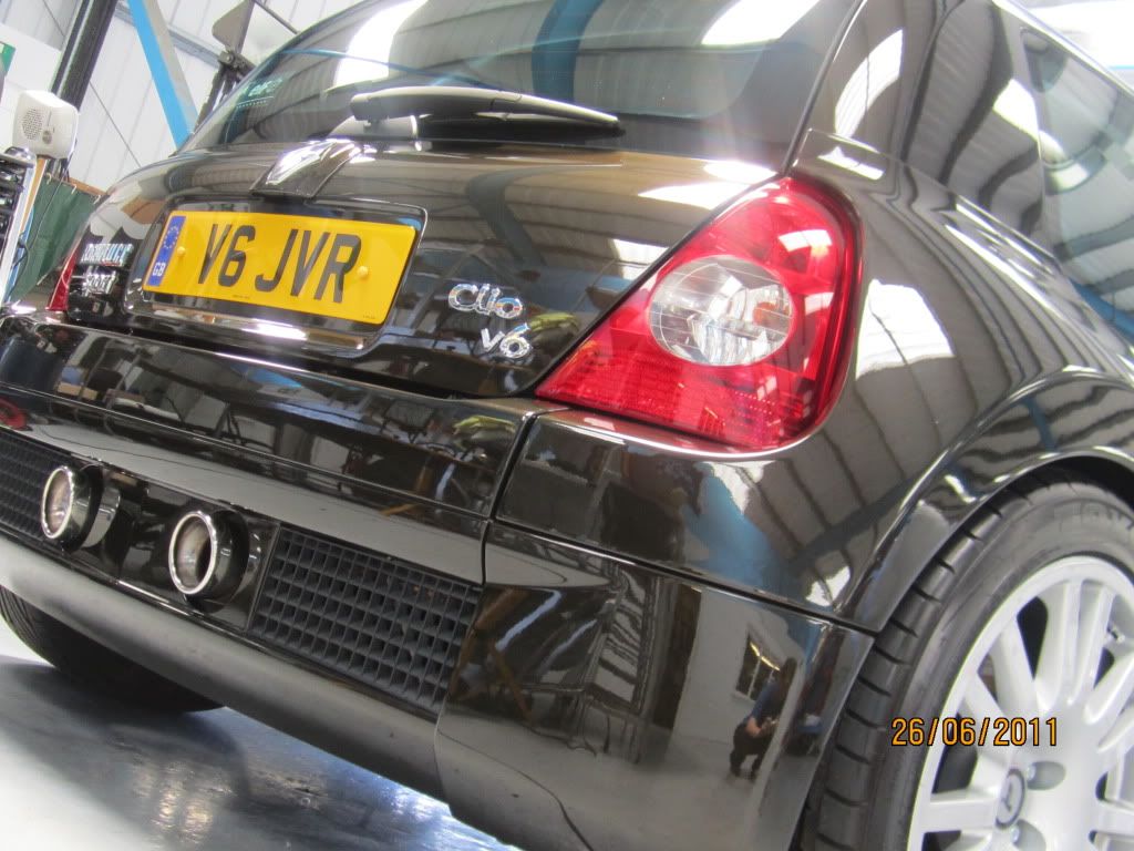

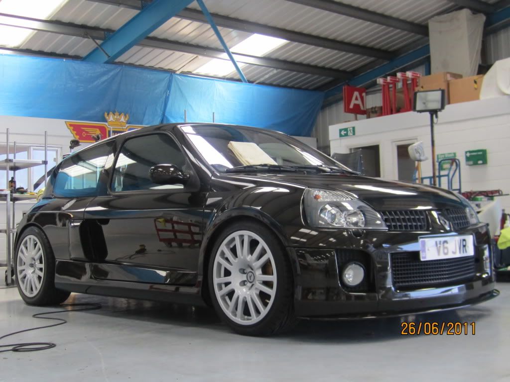

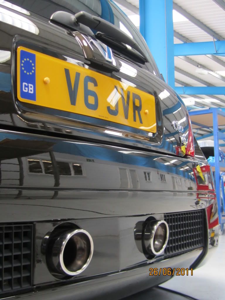

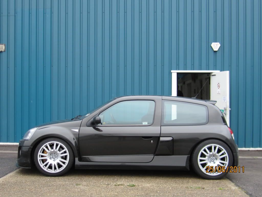

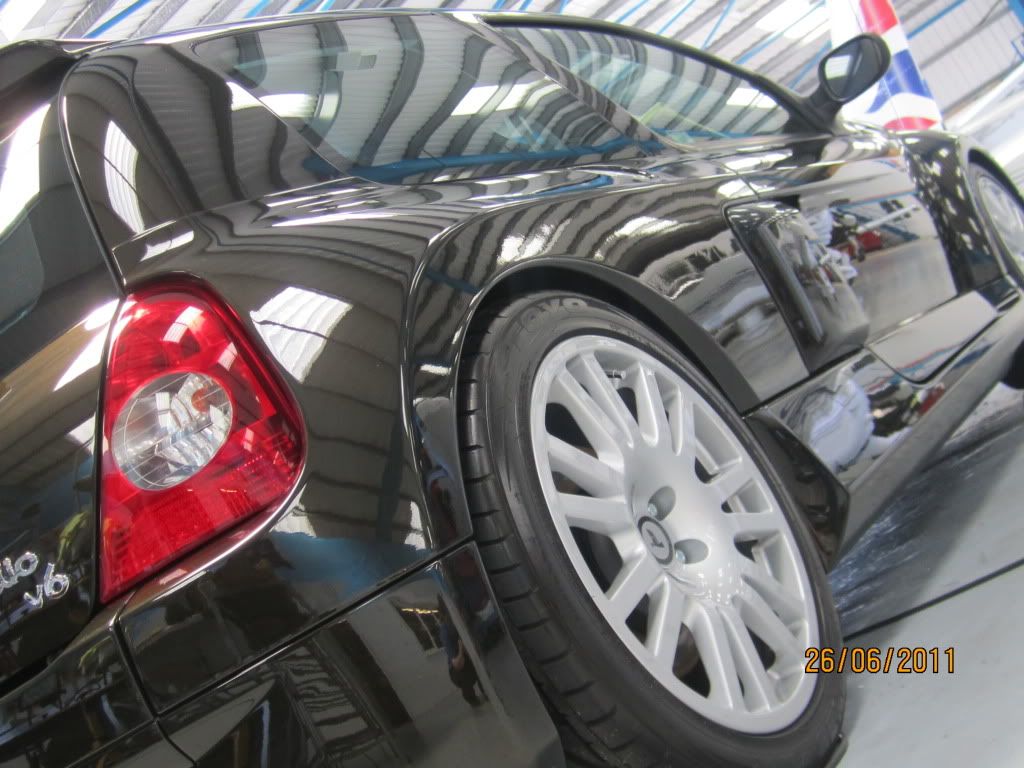

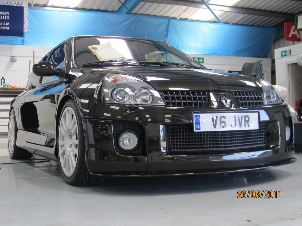

End results & a very happy James! Well im sure he was, just didn't show it very well :p

Oh my god that colour is insane!!
Why didn't Renault show it like that in the brochures! Im sure they would have sold a good few!
