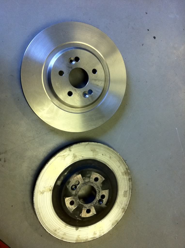

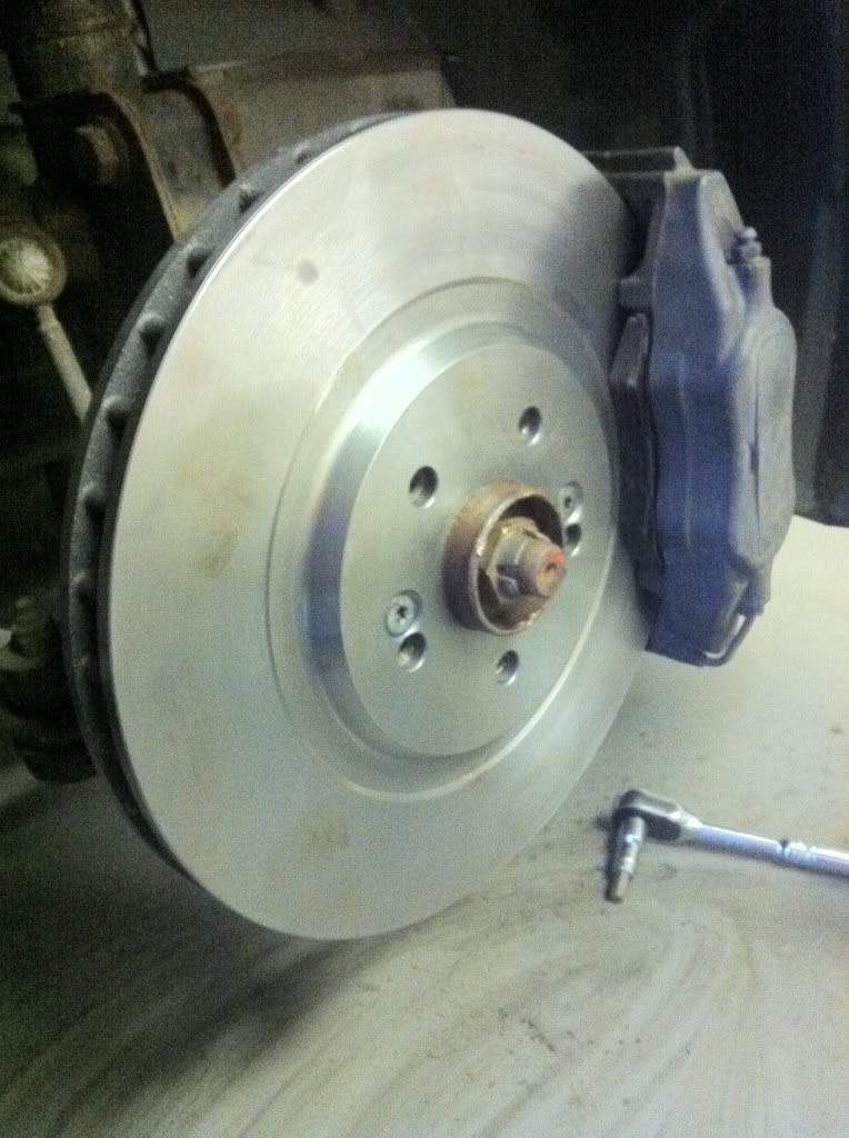

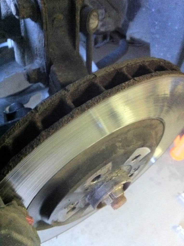

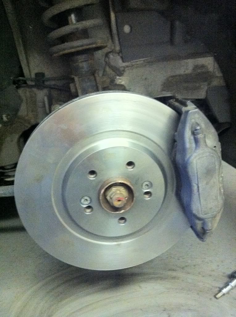

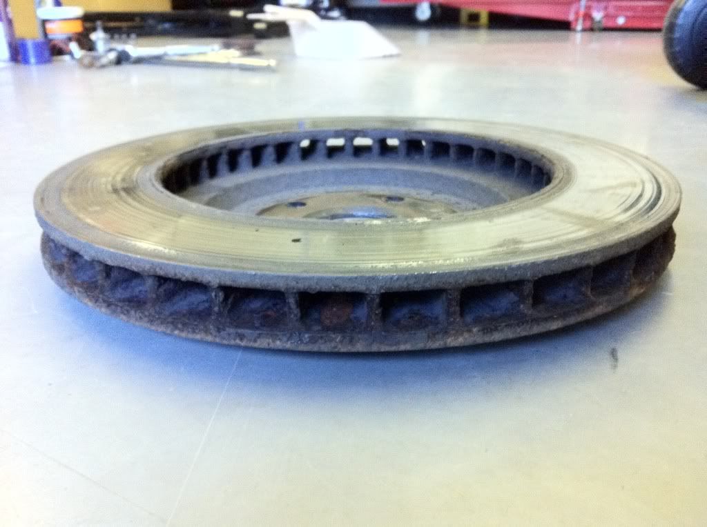

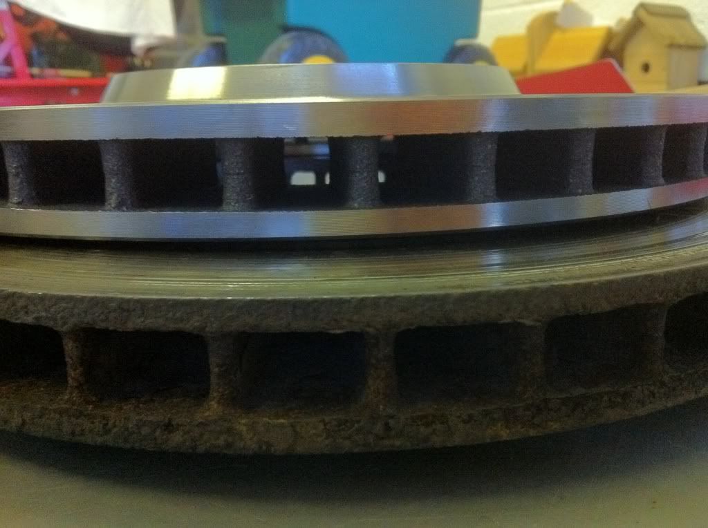

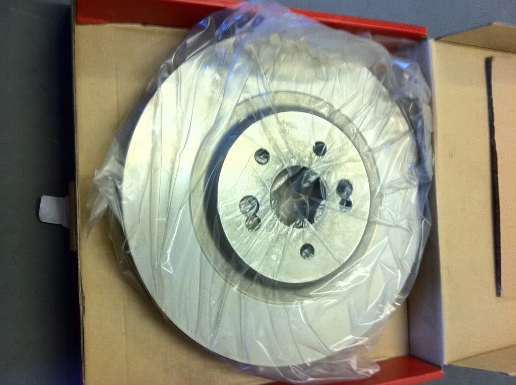

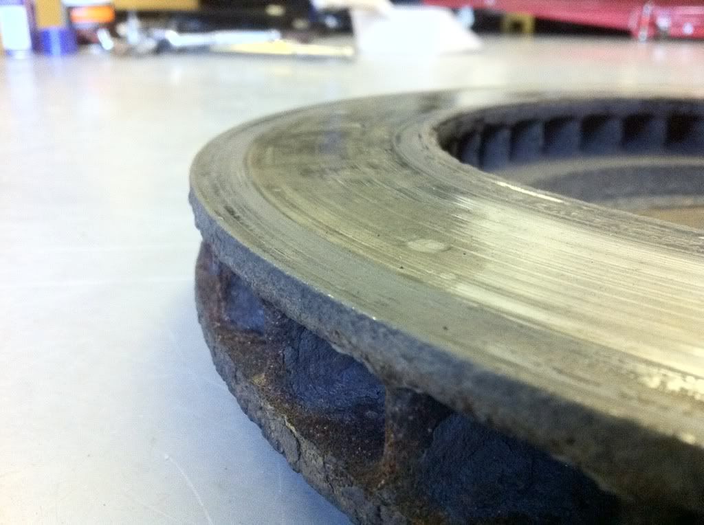

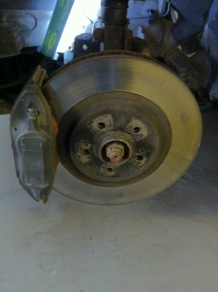

A few people have been asking for photos of these discs, and I managed to get round to fitting them tonight. Fitting was very easy and the old discs, although very badly corroded came off easily and the calipers were in good shape. A quick blast with brake cleaner and the new pads went straight in with a coat of copper ease and the caliper pins cleaned up nicely too.
I can see why my discs were binding so badly, the O/S Inner was badly scored and fit for scrap. Shame really, as it had EBC Redstuff pads fitted fairly recently by the previous owner and they were hardly worn.
Here's some photos:

Yes as mentioned above, its 2 large hex bolts that holds the caliper on, one top and bottom and then I think its the ABS sensor that attaches on a bracket between the caliper body and the bolts. dead easy to get off on my car, they were tight but a spray of pentrating oil and a long bar with a hex socket attachment had them off in no time.
As Spike says, you cant get the disc on/off without removal of the caliper.
