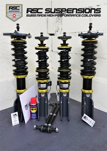

You will never come close to the damping performance / set up of a progressive double piston monotube damper with a piston diameter of 44mm. No way.
The other adjustment options are not even mentioned,
such as adjustment window adjustment of bump and rebound, stabilizer height (Ph2), adjustable camber plates, car height separate from the spring preload etc., etc.
As already mentioned, the negative driving characteristics of the V6 (the fact that it doesn't even have a stabilizer on the rear axle says a lot)
can largely disappear with such an RSC.
The V6 is no longer recognizable, and driving pleasure increases immensely.
Regardless of whether the car height is set in the OEM height or a little lower. Everything works.
