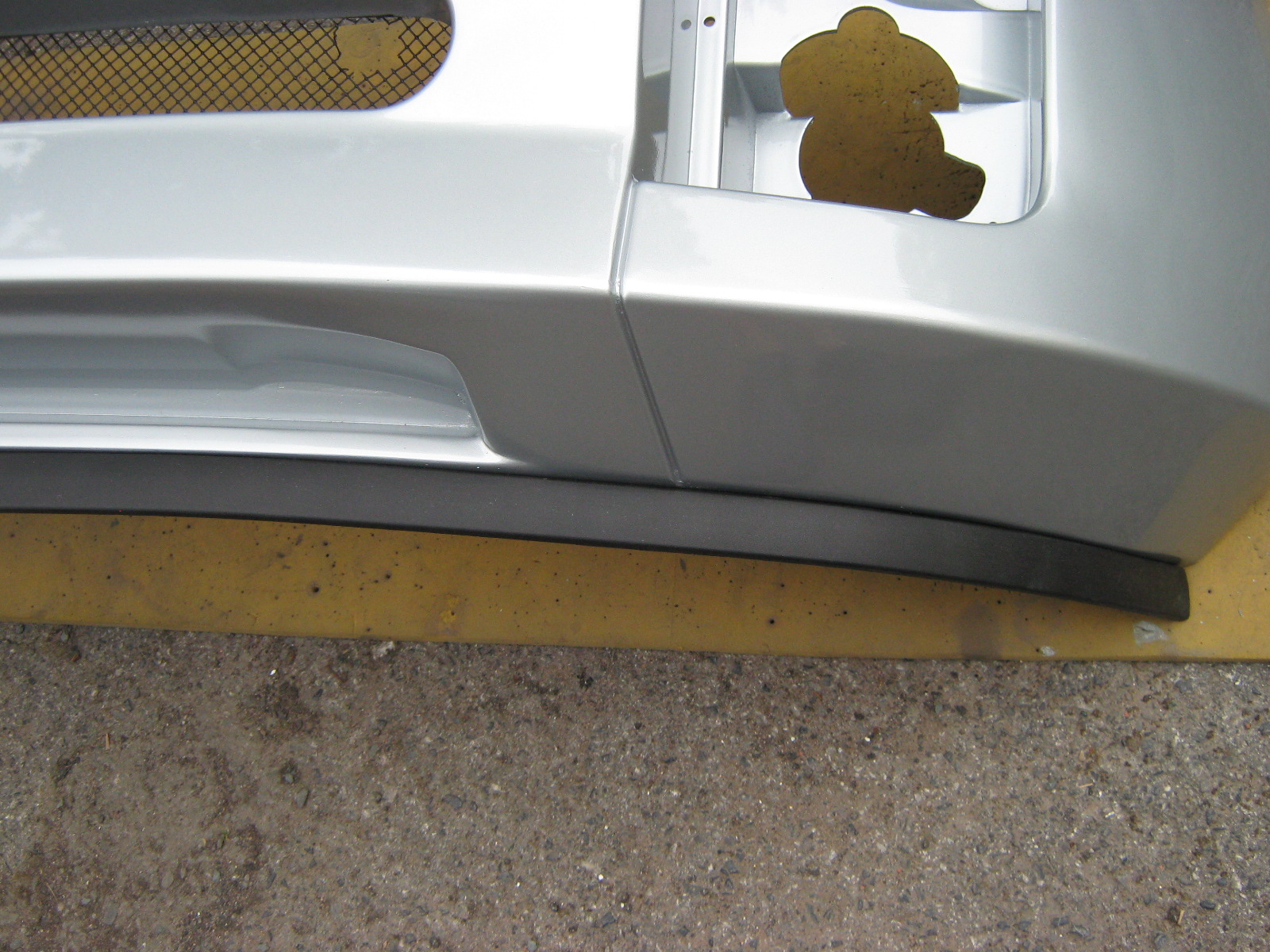

Just fitted a Fabia front splitter to a ph1 bumper. Bought new off ebay for £17.50 delivered. I fitted it whilst the bumper was off which made it quite easy They are quite nicely made from a rubberised plastic.
It does reduce the already low front clearance by 30mm.

Brilliant, funny have thought about the Fabia splitter before but assumed it would not fit. Considering the price of an a V6 splitter, with a large chance of it being ripped off (again) this is a great find.
Was any cutting involved and could you post a picture once the bumper is back on the car? :approve:
What is this made of? Only reason I ask is because the OEM item is made of (pretty) flexible rubber rather than a plastic derivative. I never fitted mine as I'm told it would catch on everything, however due to it's flexibility it (and the bumper it's attached to) would mostly emerge unscathed.
Just as a head-up for those that are considering it to work out if the material is hard exterior-type plastic (as it looks to be) I imagine you could do a bit of damage to the underside of the bumper if you were to come down hard on the splitter at the right angle - say taking a speed bump too fast and nudging the road the other side and bumper repair/replacement is a faff.
