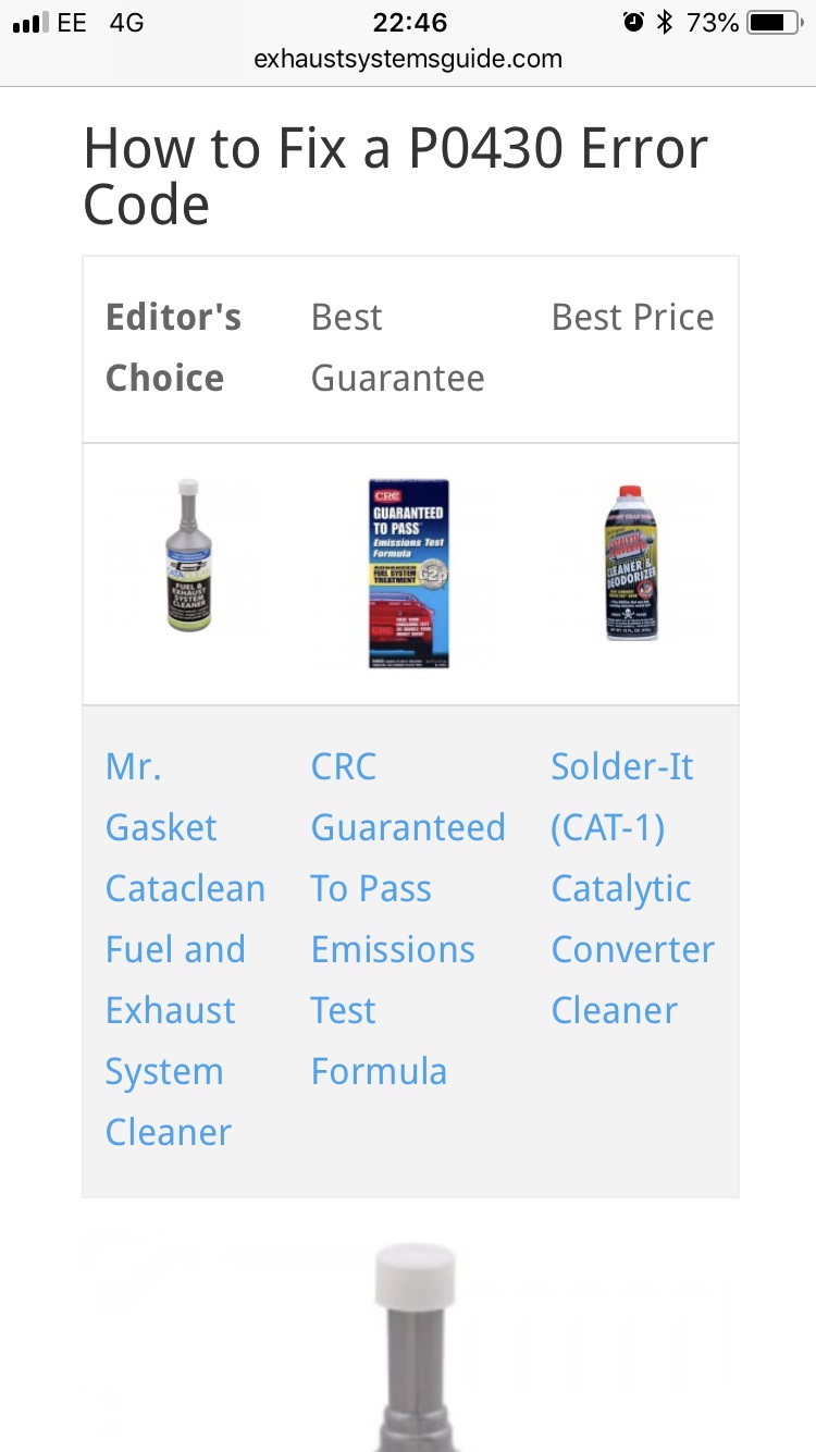

Is this worth a go first?

As far I can muster - 90% of overall Vee faults (which fortunately are few and far between) are attributable to coils packs failure or 10 year old starter motor failure.
The symptoms you are describing could be either. Once the problem is resolved, trouble-free motoring beckons...

Kett is spot on, mine was relictant to start at times yet other times fine. It was starter motor, the oe has glued in magnets and i suspect on mine a magnet had come adrift and the starter would have to overcome that magnets resistance depending where it parked itself. Mine was replaced with a bosch unit with bolt in magnets. I did replace battery anyway as it was original so was 12 yrs old. I doubt engine management light is as consequence of either issues and mine only ever illuminates when coil pack fails.
I’m always sceptible of additives but as long as no reports of ill effects must be worth a try.
