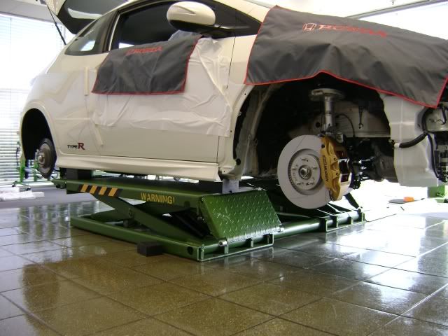

Blakey, that looks a fantastic lift, ideal for home garage use. what is it and where can you get one from?
I have been looking at lifts for a while that one is sold by strongman tools. They are made in china and are sold be a few firms in different colours etc. also has the CE mark (need to check that it is an English CE and not Chinese)
£2,245
Lifts to a height of 1 meter
3 ton lift
ratchet locking system to stop any accidents
http://www.strongmantools.co.uk/mid%20r ... 0lift.html
Need to do some reaserch before buying but seem ok.

Haha! Id love to get one of these but I suppose the biggest question is, does it allow enough clearance at the back of the car to drop the engine and gearbox?
The other slight problem is the cost, I know something like this aint gonna be cheap but thats the cost of 2 cambelt changes alone, so I have to ask myself the question, will I use it enough to justify the price. I know you can do oil changes etc a lot easier.

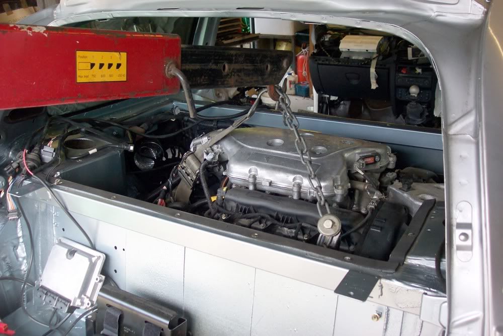

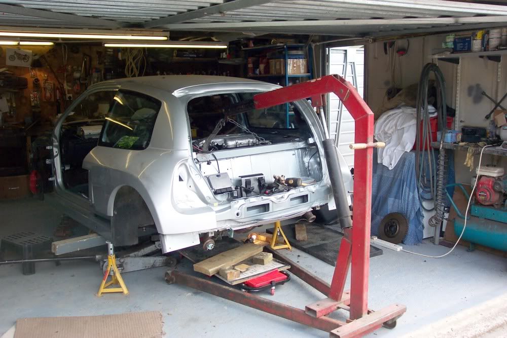

D61 update again
12 hours on the car today and good progress, inc engine back in.
I was asked how I was going to get it back in at home, here's how, by the way I was on my own doing this, I gave it some thought,I first got out the engine hoist and lifted up engine and put on a 6 wheeled low level crawler , blocked up the engine level (I never use it for going under the car though) then remove the hosit
Next get a 6 foot lenght of 4 X 4 timber and place it under the car were the tank is, blocked up so not to put weight on the tank, then the tricky bit you need to use this to fit the car high enough the get the crawler and the engine under the car. Scary.
Next postion the crawler so the engine in the correct postion, then lower the car over the engine. Once the rear hatch is at the same height as the engine hoist put the car back on to the axle stands.
I hand already fitted a chain and racket strap to the engine block that held it level, do this check before you try to fit the engine.
I then pushed the hoist though the rear hatch and attached it to the chain and pulled up the engine to the right height and bolted up the engine mounts.
Lot of setting up work before hand made it a fairly easy job. The rest was reassembly of the pipes and cables etc.
