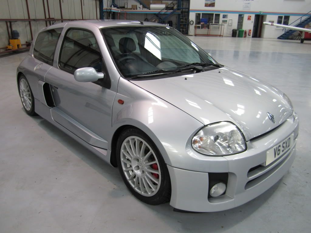

The process -
Snow foam mix with G101 & Ice Shampoo
Wheels cleaned with Autosmart
Washed BTBM
Iron X Soap Gel .... Utter cack imo! I waited for purple, nothing!!??
Clayed with Zaino bar & DJ PP
Tardis
Washed again
Towel dried
Paintwork refined 205 by hand (love this stuff)
Chemical Guys Virtua Bond
Chemical Guys Blacklight
Chemical Guys QD wipe down (Blue 1 with Carnauba)
Megs #16 Wax
Werkstatt Gloss Sealant
Usual niff naff & trivia finishing touches
Pitty it was wet come collection time! :(

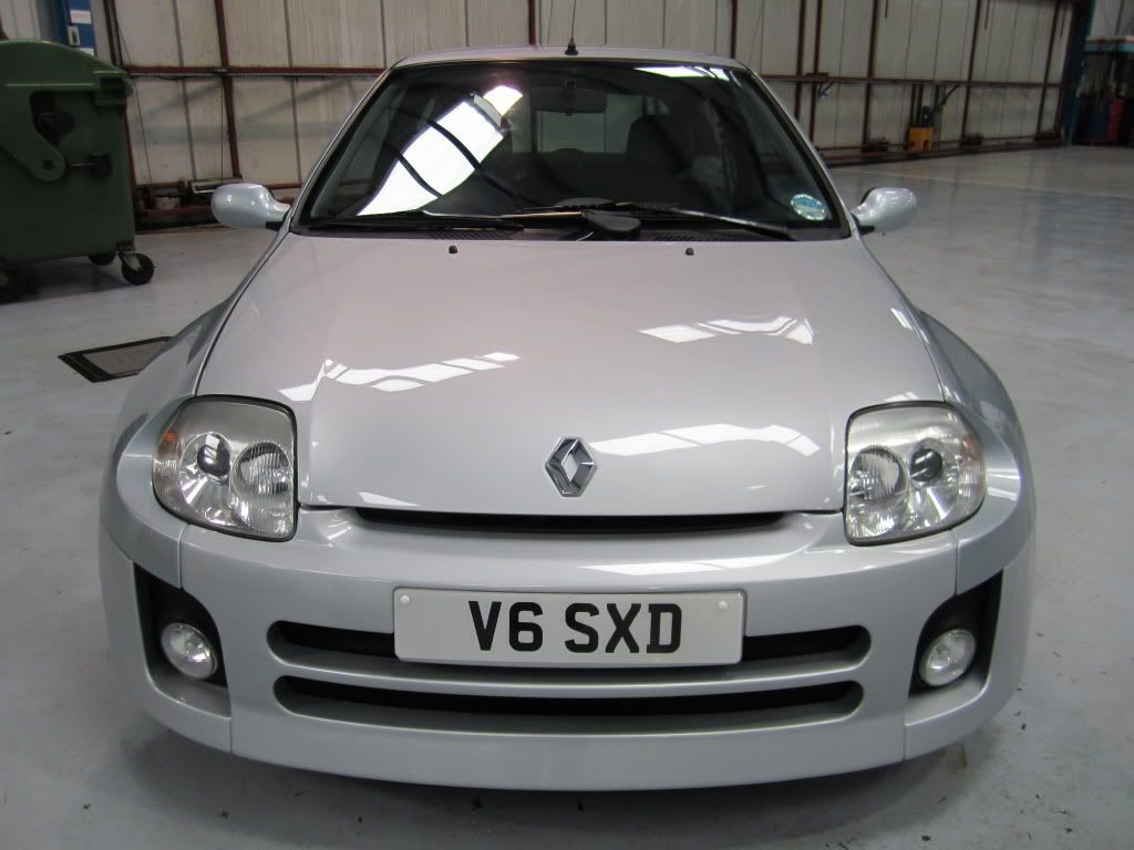

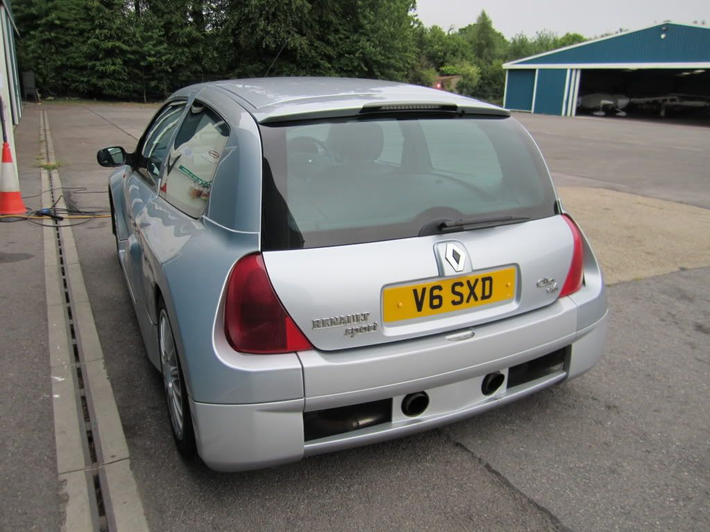

Just a few befores Yo! :p

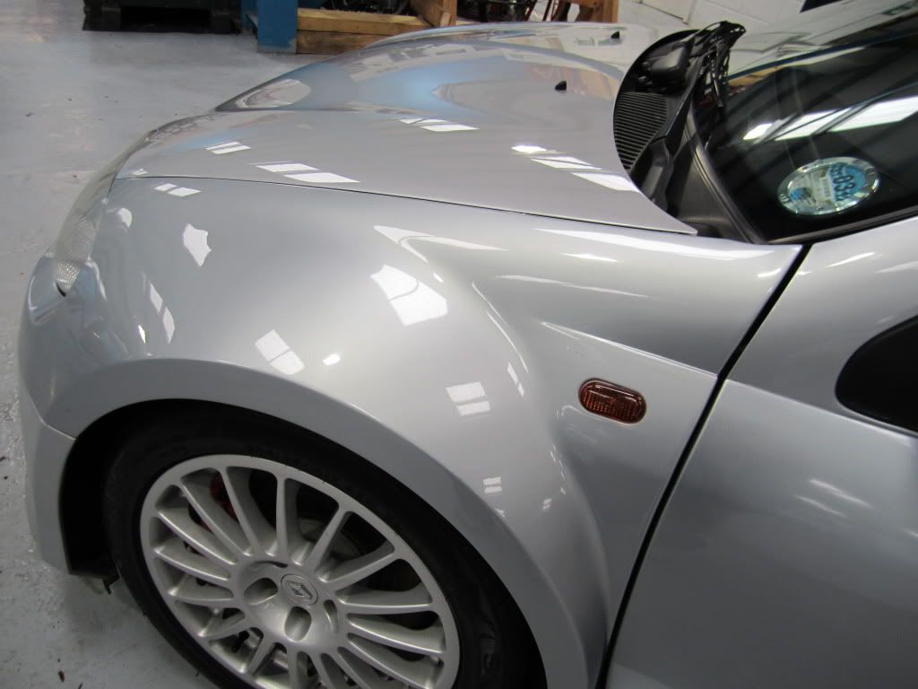

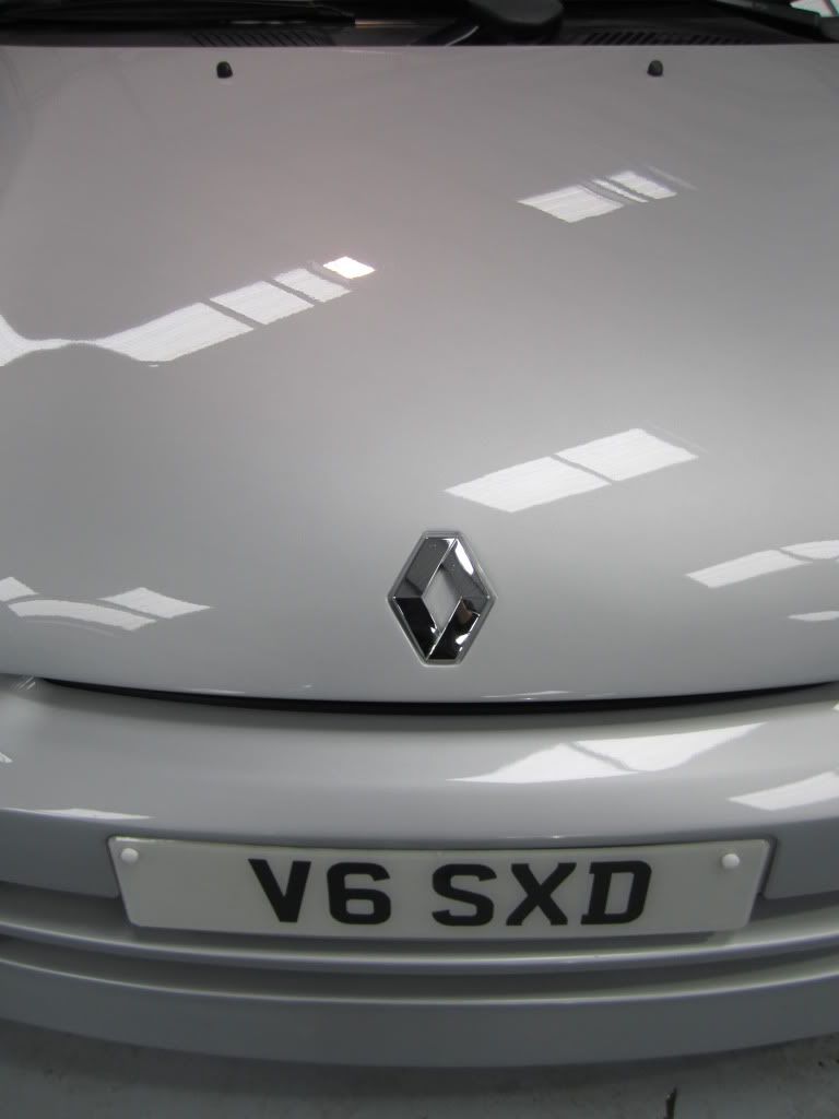

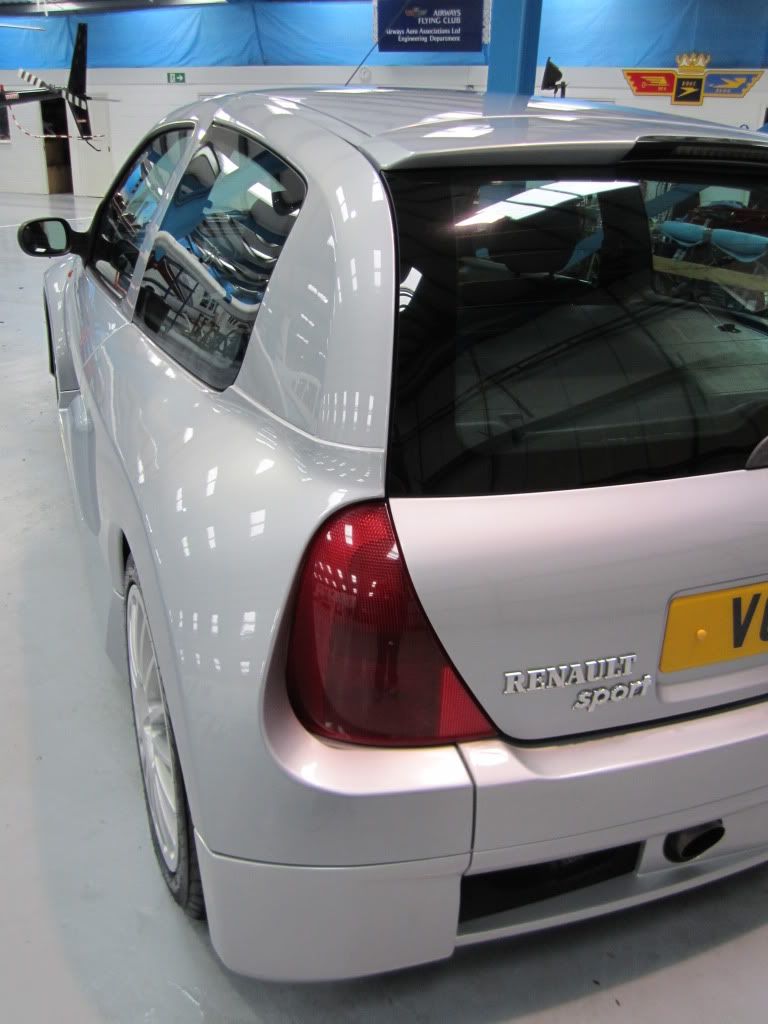

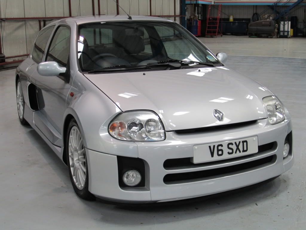

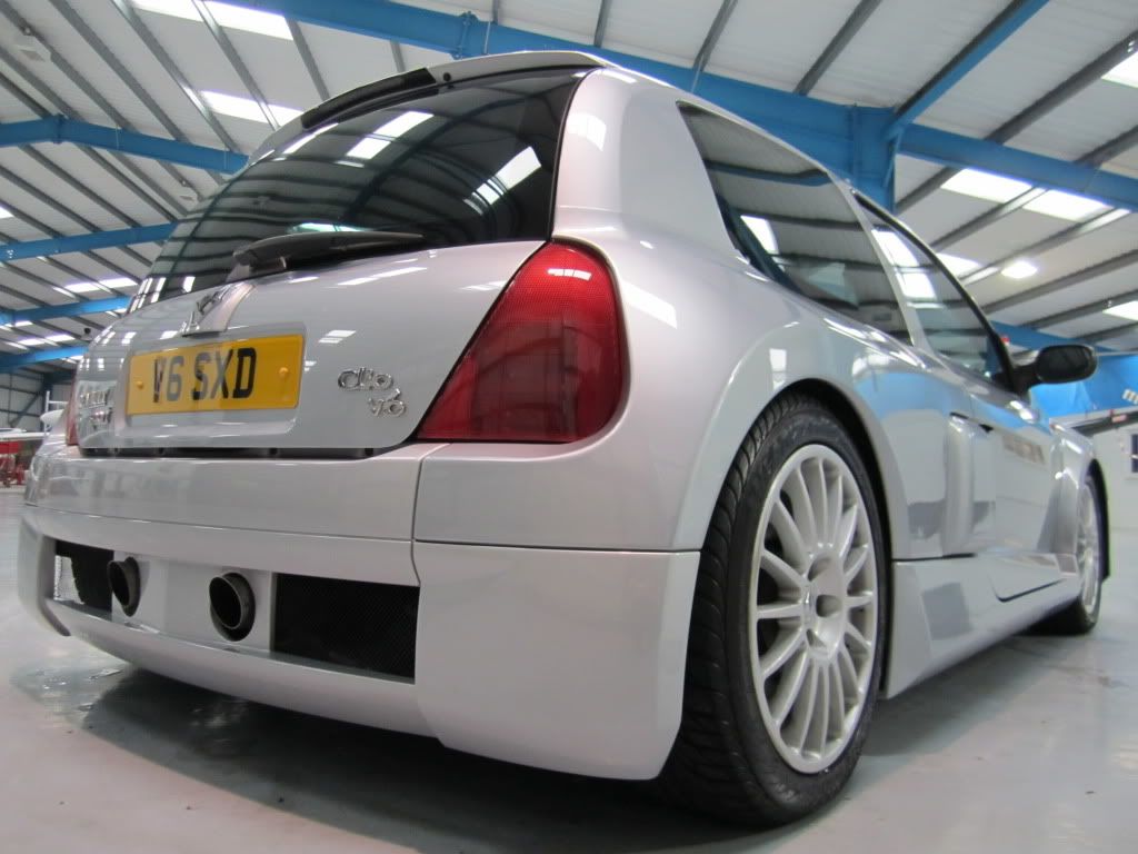

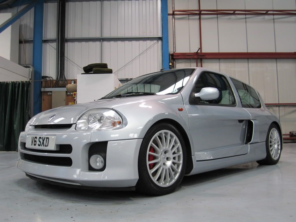

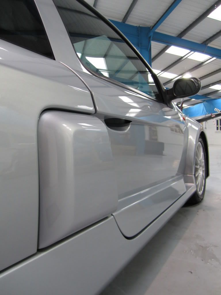

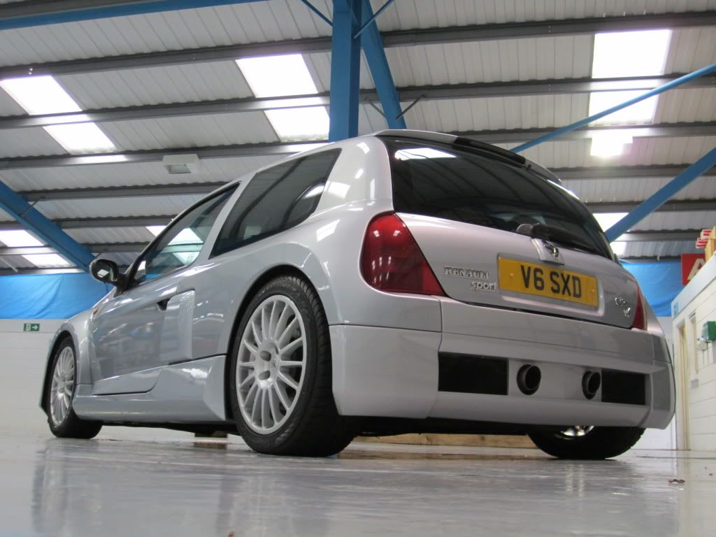

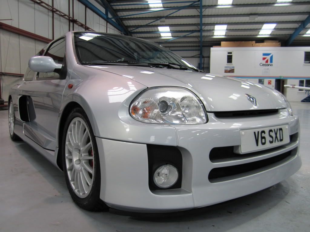

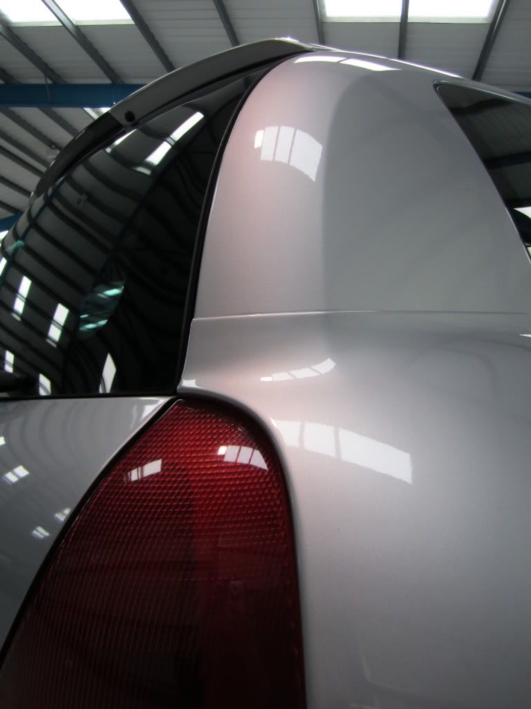

Some afters, got carried away ... Betty needs a younger sister :argie:

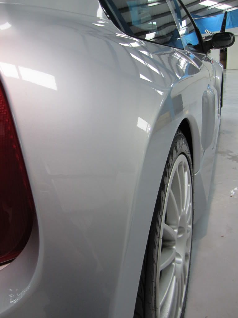

Thank you sooooo much for the care and attention you gave our little baby. Absolutely stunning. Just a shame she looks like a checkers board now. Will have to have the doors open at FCS so it's not so noticeable ;) oh and the missus is Sarah :) Really happy with the superb job you've done!

When I see standard Ph1's this tidy I sometimes regret doing what I've done. In my opinion, its the opitomy of what a V6 Clio is.
As some of you have spotted, it has obviously had individual panels resprayed at different times.
As the new owner, its history is gradually being revealed. Firstly, Scott has highlighted some interesting things and now Dawn has revealed more.
In normal daylight and before the fab magpie detail, the differently shaded silver panels wasn't too noticeable. But now it had a good clean, it shows up like a checkers board.
Already started to make enquiries about a total respray. Have been recommended a chap who restored a friends mini. Looking at proper windows out job and not a quick cheap fix.
Just gotta save up some dollar now....
Pity, but the car looks flawless on first glance! Plus there is no hiding blemishes under that light!!
