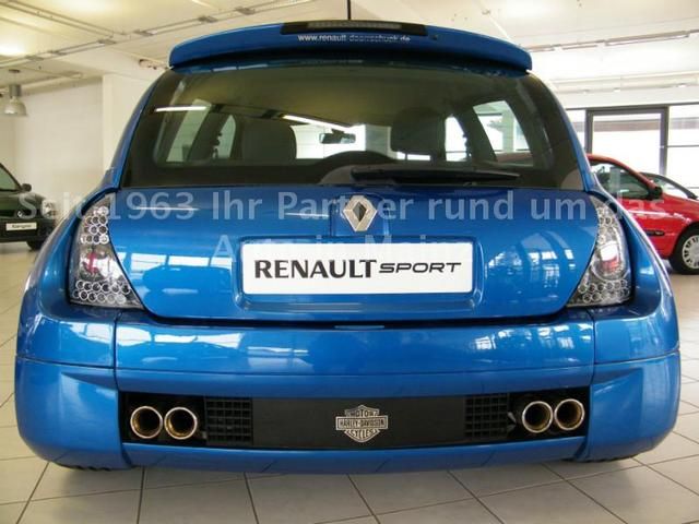

Italy, no.210
Netherlands, no. 109
http://s7.directupload.net/images/130729/22qrtr6s.jpg
Germany, no. 181
http://s14.directupload.net/images/130729/aujz82g6.jpg
Spain, no. 16x
http://s7.directupload.net/images/130729/brt4yqgr.jpg

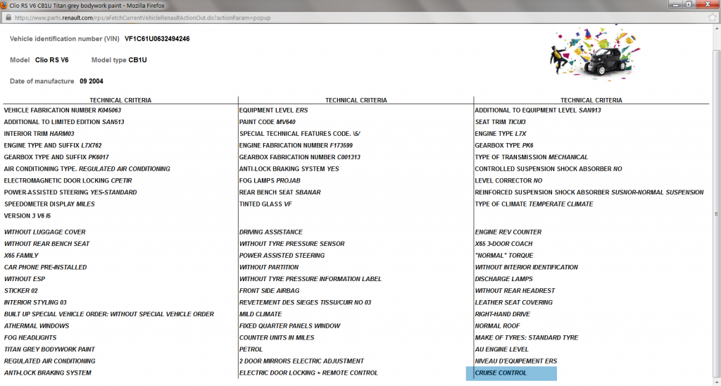

A typical spec sheet for a UK VIN number car

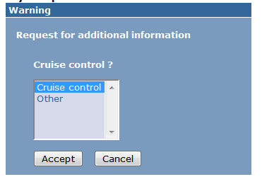

When selecting a steering wheel on the parts database, you are asked to choose cruise control or not.
A lower dashboard switch blanking plug is also listed for non cruise control cars.
I've also looked up various non UK cars using their VIN number and they all show cruise control listed.

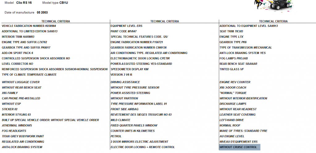

I also noticed something different.
It''s not regarding the CC though...
Theres an entry in my specs your "typical UK spec car" doesn't have:
What's this all about?
That's not my car James.
I bought a silver one...
Those "extra bits" are terrible ^^
So what about the "ADD-On Sport Pack 6"?
I have VIN numbers for some European Vees. France, Swiss, Belgium, Italy, Netherlands, all of them have cruise control and no mention of Sport Pack -6 in their spec sheets
They were 103 phase 2 Vees in Germany. 28 of those are Titanium silver
I don't have any other German car VIN numbers. Only yours. :-)
