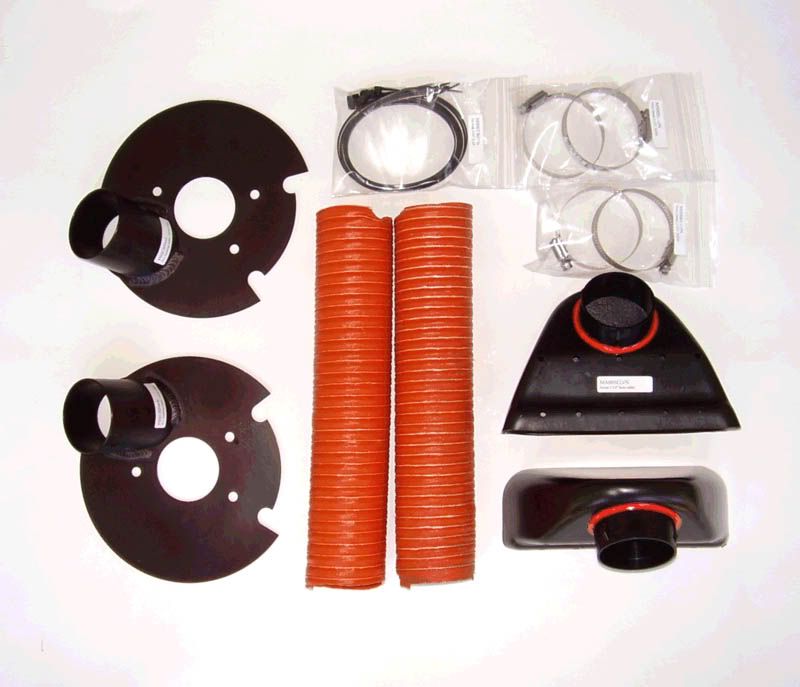

I've made a set of brake ducts before and if done correctly they do work when needed. They are pointless unless they are sorted at the disk end. I built mine from a set of disk guards which I welded a 45* bend on to. I then connected that to a flexible pipe that in turn lead to the front grill. The rest of the guard was drilled with a 25mm holesaw to let heat out while the duct was blowing cold air in.
That was my conclusion. I said to Russo - the front bumper bit is the easy part!

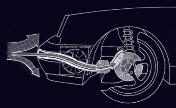

It was no coincidence that the first image shows a 964rsr type where the whole caboodle is available as a kit.
I'm assuming that you fabricated that system for a mini - was it a complete DIY job? Were the disc guards available off-the-shelf?
No, I used to run the mini without anything as the disks were only a tiny 195mm with full race spec pads. They were amazing but only when hot. The main problem was keeping them hot enough to work well but not too hot to fade and boil the brake fluid. They were way too small to do anything with other than water cool them! Lol
I did it on my Volvo S70. Braking was the one area that used to let it down after a few minutes hard graft. On the road it would stop from cold and mild use brilliantly ie in an emergancy stops etc. An area that I think Volvo always focused hard on. The problem was they gripped so well that the heat used to build up very quickly. It used to warp OEM T5r disks (slightly bigger than std cars) very quickly. Hence the reason I ducted them to the lower bumper grills. In the end, with slightly better pads, it worked very well for what it cost and left the car with good bite no mater how hard it was pushed. The best thing it cured was the constant need for new disks.

This was the type of thing I had in mind...
