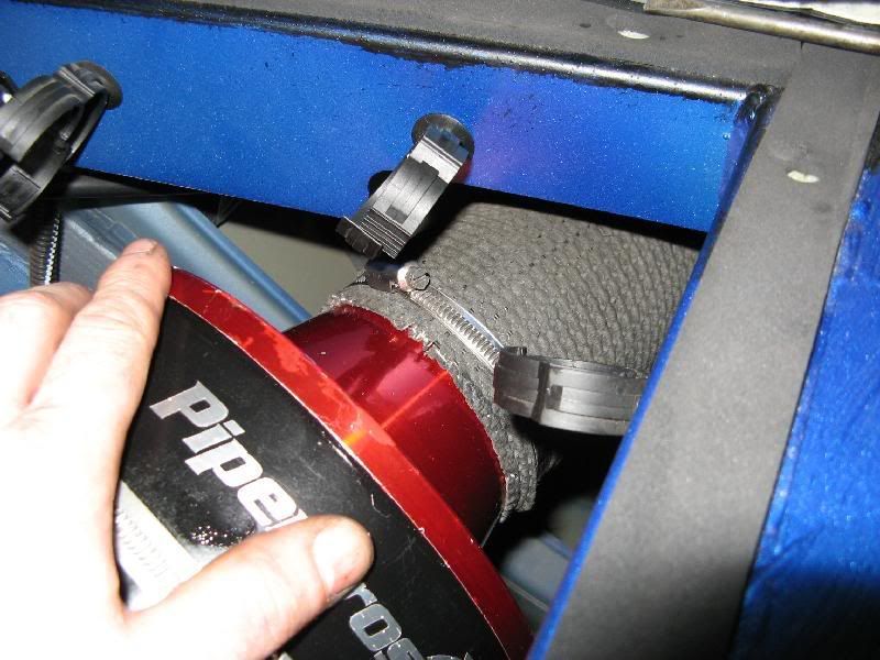

I used the reducer but on the other end
E.g. the magnesium pipe connecting to the sidepod from BMC is too small to be clamped onto the sidepod hole as it fits inside not outside.
So i put the reducer on the air filter then the original pipe on top and then connected the original pipe to the sidepod which solved the problem.
My BMC aluminium pipe is getting in this original hose what you see on the picture.
The original hose is 2cm wider as my BMC aluminium pipe . So there is a gap..
But the aluminium pipe is longer so I pushed it down through the original hose near the fan.
