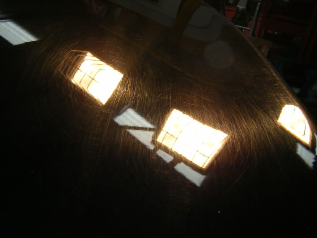

Here Is an example of the damage caused by £5 car washes. It belonged to my brother who took It weekly to his favourite hand car wash!
Some lovely random deep scratches there for you, plus very dull & flat paint.
