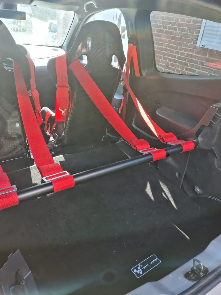

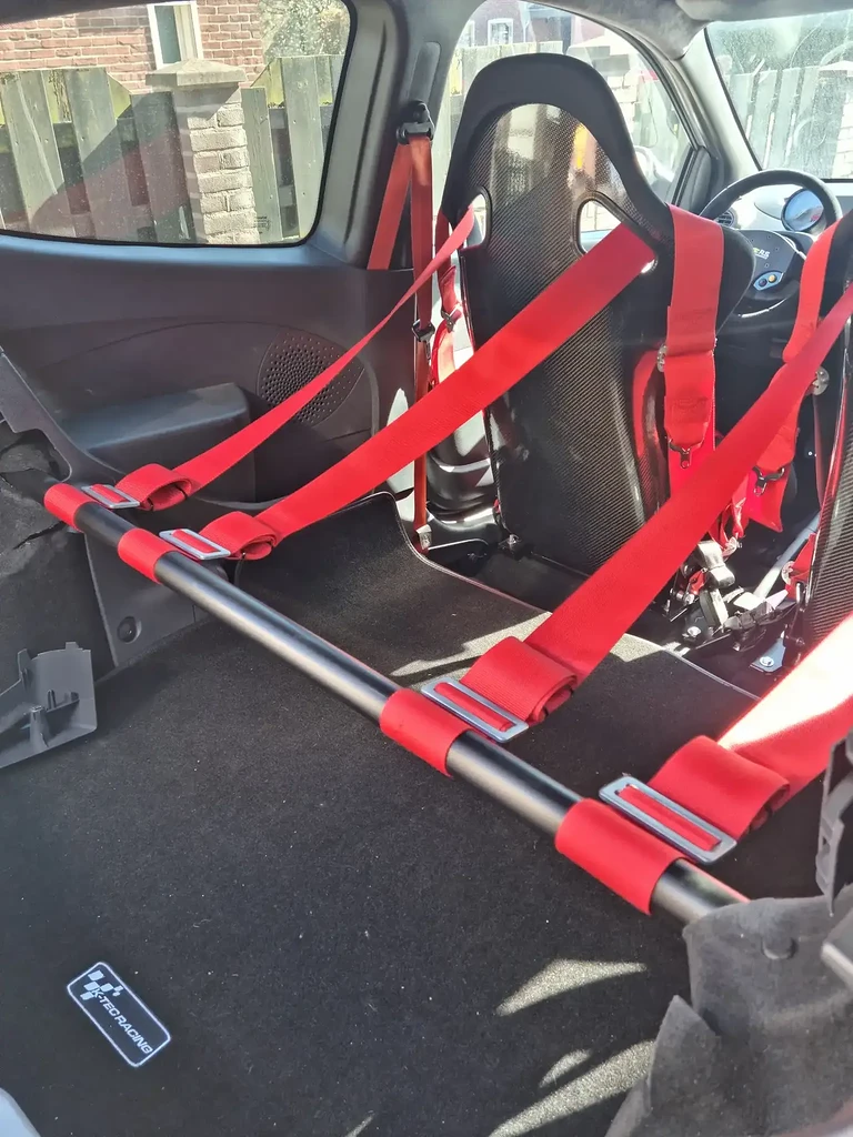

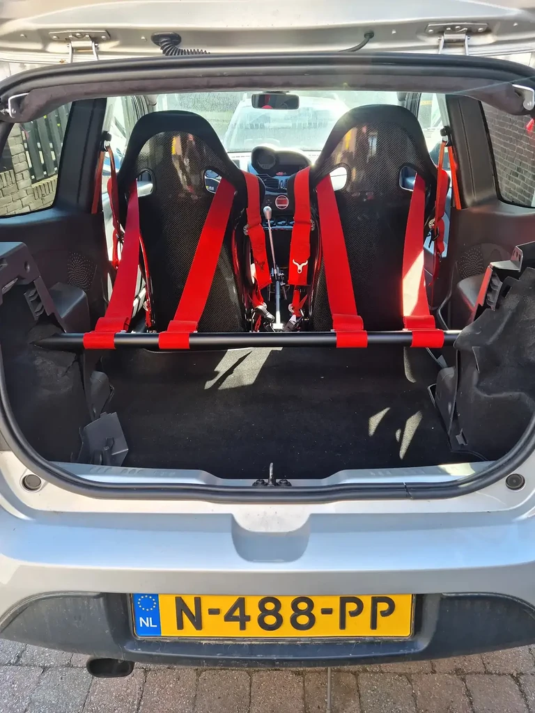

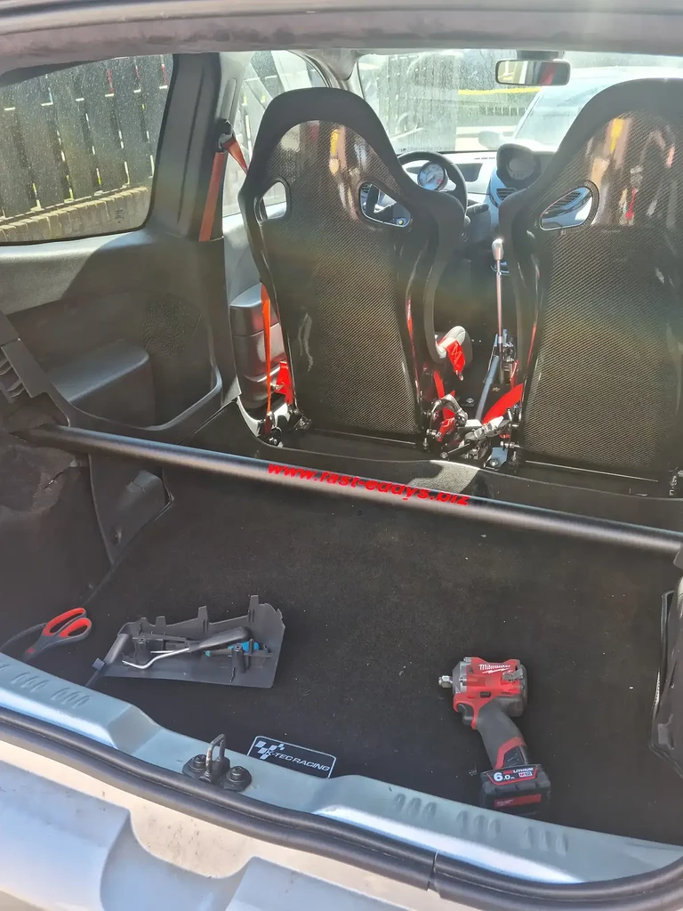

nice update, I would be interested to see some better pics of the fast eddies brace if you get chance?
Made some pictures while fitting it today. It goes on oem mounting points, and no cutting in the plastic trim.
I’ve cleaned the seatbelts in the meanwhile so they look fresh again.

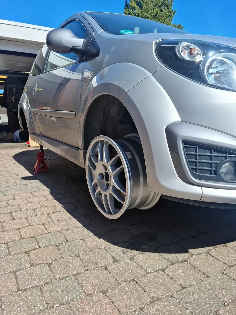

Got a set of the 16” oz f1’s for the wife’s ph1 172. When we get round to recommissioning it.

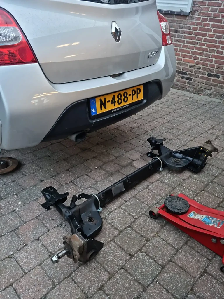

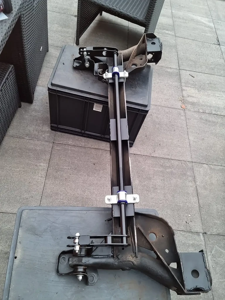

The modified rear beam is back on and its transforms the handling a lot. The rear follows the front like never before and the turn in is so much better with a little toe in on the rear beam,

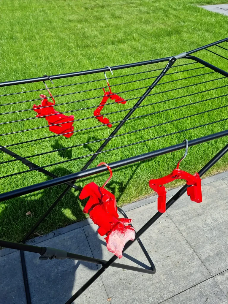

Also fitted new discs, with ferodo ds2500 pads on the rear and some new calipers in red to macht the front.
What i’ve done to the rear beam:
  • Pure motorsport stiffening profiles
  • Pure motorsport 22m anti rol bar
  • Powerflex black bushings
  • Twingo R2 Axle houlders
  • Camber -1.5 degree
  • Toe in 0.33 degree
  • Fresh discs, pads, calipers
  • Steel brake lines
Big fan of track car parts :+1:t3: Are these actually lighter than Clio’s or are they a similar weight??
I scanned past that first pic and thought it was a towbar lol

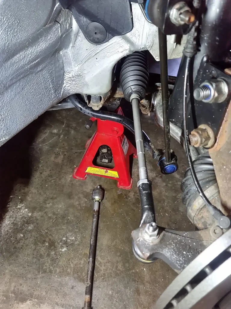

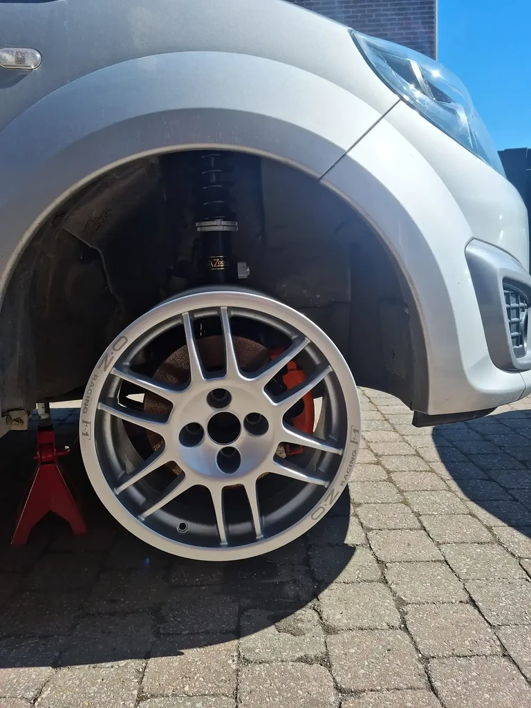

Font brakes are on and i put on some fresh inner + outer trackrods.
Finally the right front dampers arrived from Gaz motorsport, so everything is on the car now.
Got it aligned and it makes all the difference, it drives on rails now. Very happy with the outcome.

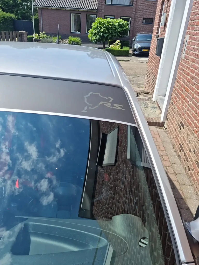

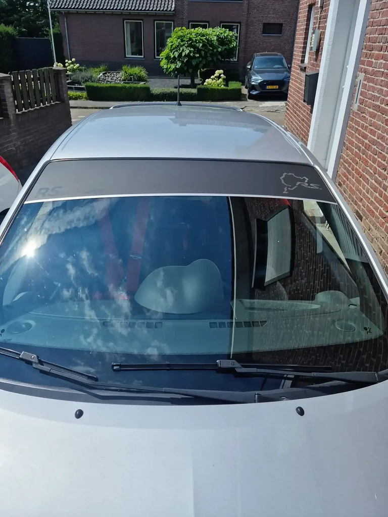

I felt something was missing on the ring pictures, so i fixed that the day after. Offcourse a proper sunstrip.

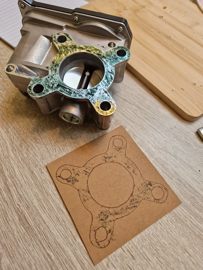

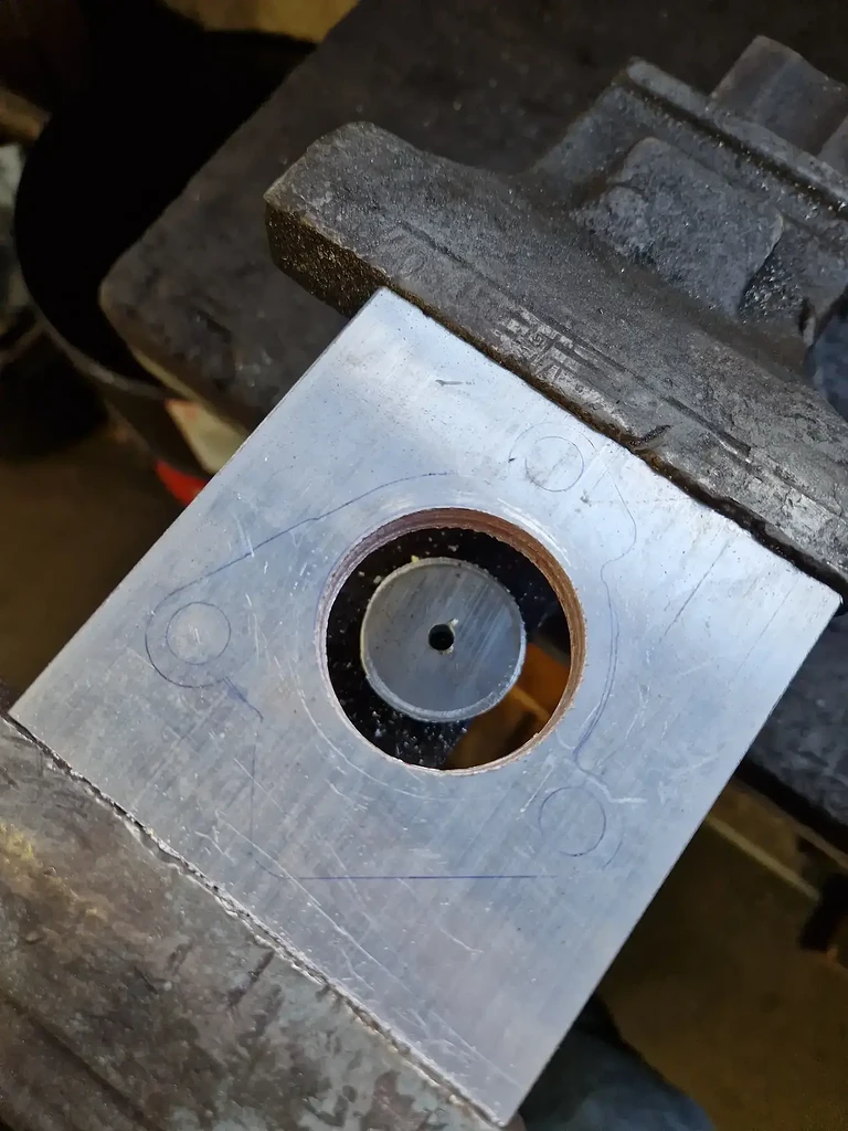

In the meanwhile i did a small job on the F4RT conversion, had to make a adapterplate for the GT throttlebody.

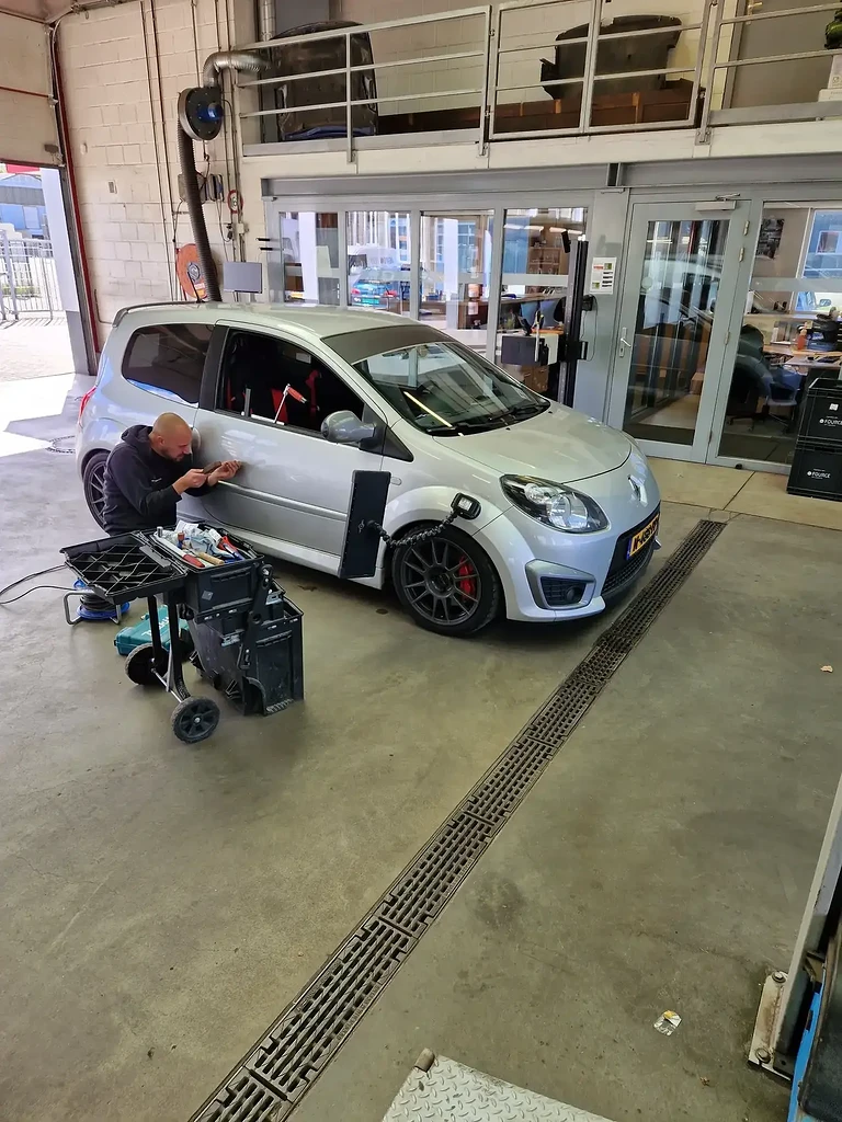

Dent removal guy was at my work the otherday, i had a small one in the passangerside door, all gone now.
