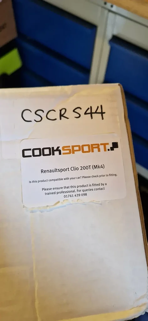

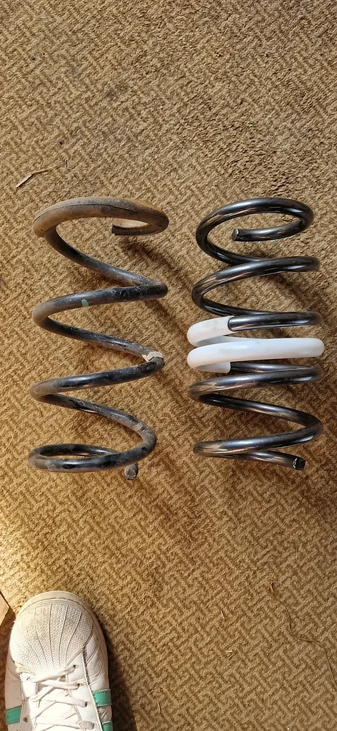

Cooksport springs on order to start things off

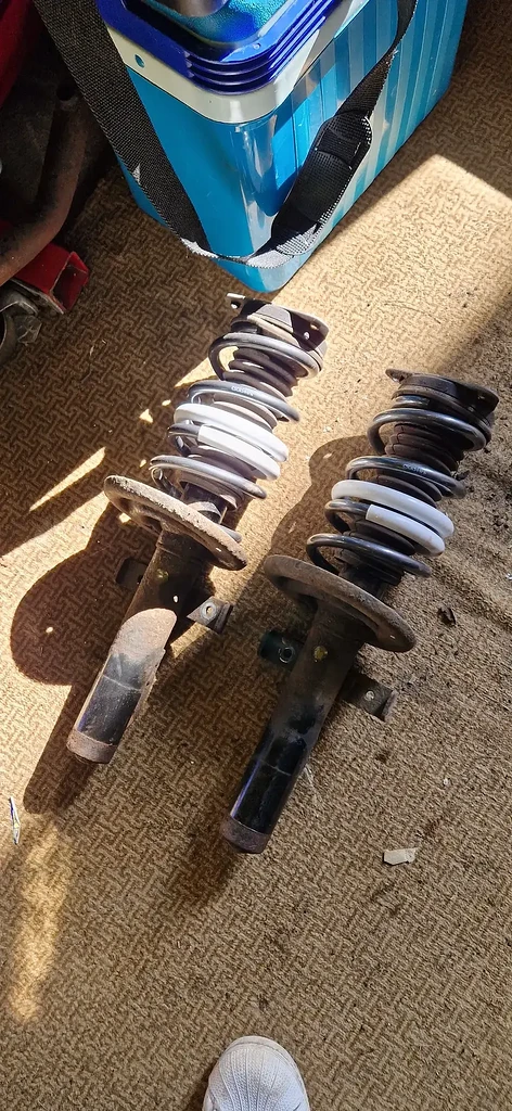

What coil spring compressor you got there a bit of a bugger
Old type that you chuck an upper and lower “hook” on the springs and wind them up. Tbh I’ve not looked under this and have no idea of the shock arrangement :sweat_smile::man_facepalming:t2:

Only changed the standard car ones but had to buy a bit of kit, they are wider in the Middle there’s a name for them , conical I think, the second coil hits the strut as well under load instead of stacking, I’m probably being a bit thick . A lot of stuff like it apparently, welcome to borrow if you need to ,

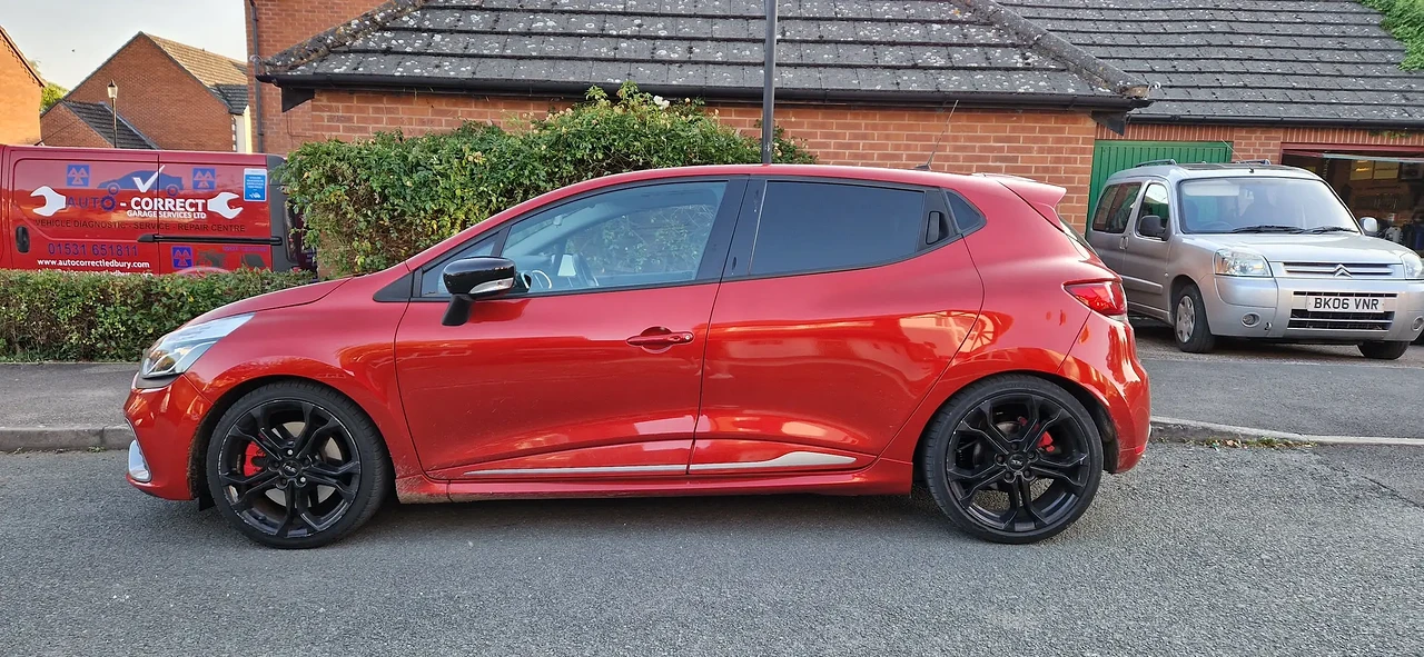

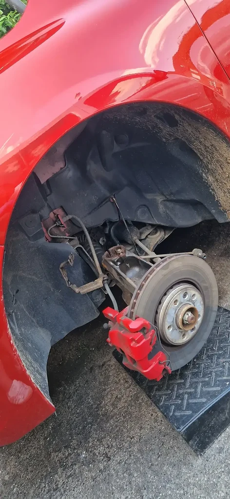

So it’s been less than a week… cooksport springs fitted this afternoon and the symposer thing blocked off. Fitting was easy as really, there’s plenty of droop in the suspension and you don’t even need to use spring clamps, win there. Its not been driven yet so I’ll let it settle before booking in for alignment. Jez was poking around under the car and noticed it has a center box delete already too which was a nice find. I do have a rotational noise on the front right, I can’t feel play but I think it’s the wheel bearing. I’ll keep an eye on it and get it swapped out soon. Hmm what’s next…

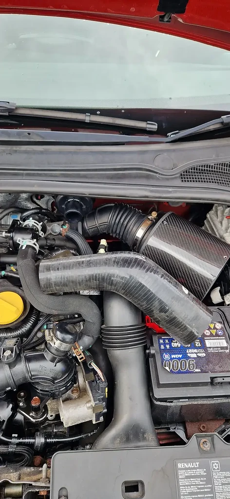

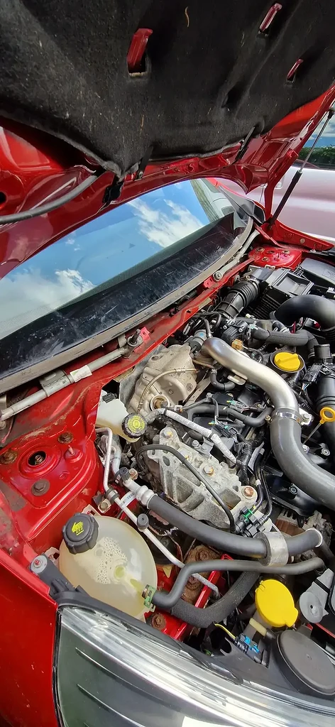

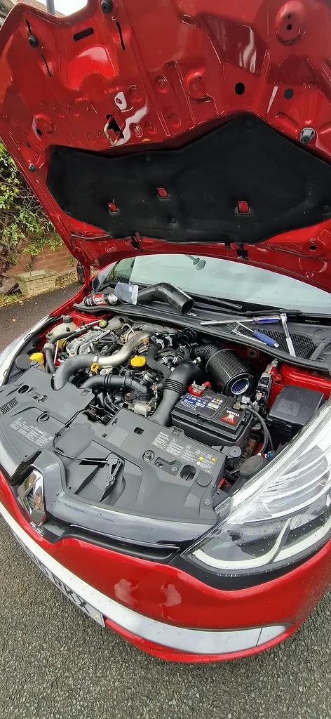

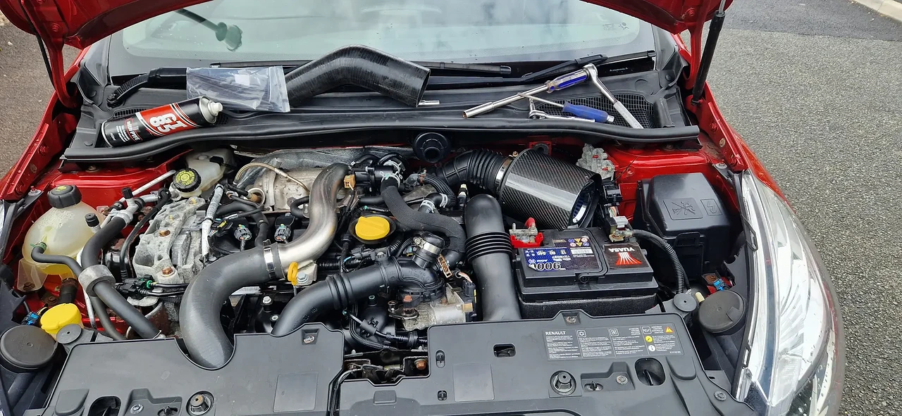

So I was meant to be out with everyone at Oulton today but bailed due to the weather. So in between the rain and wind I’ve been tinkering. Surprising what you hoard in the shed over the years.
ITG induction kit… nah… how about PMT induction kit :grin: I almost have the right filter to turbo pipe too but it’s lacking the n75 valve takeoff. Forge Motorsport sell one and are local to me so I will go grab one to replace the corrugated pipe. Sounds a little meaner on boost with a little love puff when you release the throttle :laughing:
Always lube up the wiper spindles when in there they can be trouble some. looks Tidy

The car drives lovely on the cooksports, tbh you wouldn’t even know even know its on aftermarket springs.
